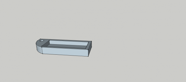

My build is underway and one thing that I haven't yet figured out is how to incorporate the Camp Chef Explorer, 2 burner stove into my galley. The stove is about 34" wide and I really don't want it just permanently installed into my countertop as it would take up about 50% of my width. I also don't want it to slide out on heavy duty cabinet slides because I don't have 34" of depth to hide it away into...
What I am leaning towards is to have it swing out 90 degrees from directly beneath the countertop. This will need to be on a single point, heavy duty rotating hinge... any ideas on what to use? I could try to build around a 1" heavy black pipe with threaded flanges at the top and bottom. I would build this from a mix of 3/4" birch ply (top/bottom) to deal with the stresses of the pivot point and 1/2" birch ply for the front, back, sides. My sketchup skills are pretty weak but hopefully this gives you an idea. The pipe/hinge that I am referring to would pass through the hole at the top/back of the swing out. The stove alone weights about 30lbs...
This won't be a light weight add on but I haven't based my build around being very light. Appreciate your opinions and feedback!

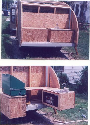

Here was my take on the flip out galley............
and I really love it !

Postby bobhenry » Wed Feb 24, 2016 10:04 am
put a chunk of 1x12 blocking in the wall to screw into and installed two standard residential door hinges on each swing out cabinet.
They are big 4" ers in this pic you can make out the hinges and the solid blocking is not covered yet.

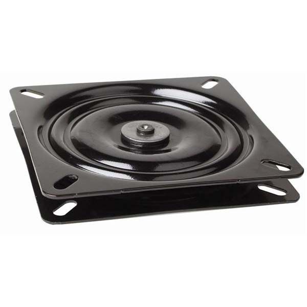

What would your opinions be on using two of these - one on top surface and one underneath, securely mounted to underside of cabinet and to bottom. They are swivel mounts for boat seats. I am sure they make a really heavy duty one for XL fishermen...

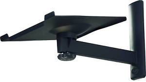

Have used these in food trailers for swing out Grills and such. It is an old style TV Bracket. Have seen them in thrift stores and ebay. Thrift store 5 bucks, ebay up to 20
tv bracket.JPG (4.86 KiB) Viewed 1022 times
