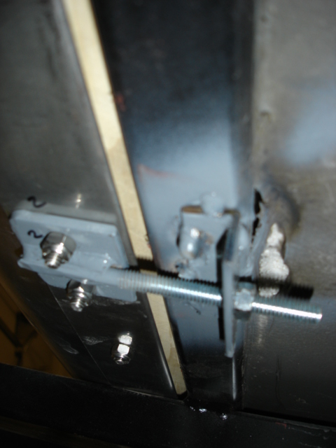

I would like to pass along an idea that was tried on the Three Texas Teardrops Project. After watching the trouble with attaching the top skin on the first Teardrop, I tried to innovate a way to tighten the top skin with a tension device. It worked very well. I was able to tighten the skin in just a few minutes with a ½ inch wrench; I can remove the top skin and make adjustments very easily.
The picture shows an all thread rod that is welded to a flat plate. The flat plate is bolted to a stainless steel leading edge that is wrapped over the .040 aluminum skin. The stainless steel leading edge is a 3” wide piece that is folded in half so the total width is 1.5”. A piece of angle iron was then welded to the bottom of the front frame. The all thread is passed through the angle bracket and the nut is tightened to desired tension.

On your tensioning system...Did you consider using a spring below the adjusting nut? That way the skin could contract and expand as it wanted.

Yes, I did consider that option. The spring idea would make a very good floating system. I plan to put an A/C unit in the front and that might affect the expansion and contraction of the top skin. I was very please with the ease of tightening the roof skin and not having to use straps.
Also, I used four of these devices on the leading edge of my teardrop.
Thanks for your reply. You are welcome to any of our ideas.
Garland

This system does not just hold the skin in place. I developed it for two reasons.
1- After skinning the first teardrop I noticed that if one of the sides was just ahead of the other, by even a 1/32”, it would cause a wrinkle in the top. With the tensioning system I have control over the top skin. I can apply more tension to one side over the other and remove the wrinkle.
2- I was told that it would be a good idea to skin the trailer in the hot sun, so that the top skin would be fully expanded. It is winter time in the Texas Panhandle when I skinned the top of my teardrop. The tensioning system allowed me the advantage of stretching the skin during the winter. I can readjust the top skin in a few minutes if needed.
It was not a lot of trouble building the tensioning brackets. I made it out of some scraps that I found around the shop, but it help to have a chop saw and MIG welder.

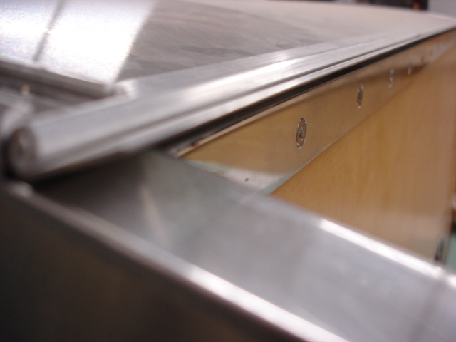

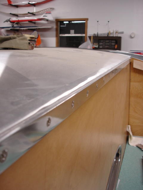

The rear of the top skin was bent 1” down at a 90 degree angle. I then fabricated an aluminum retaining bar 1” x ¼”. A screw was counter sunk about ever three inches. The retaining bar sandwiches the top skin to the kitchenette wall. The second picture show the hatch hinge. I will have to use exposed screws on the hatch hinge but I will use lots of Pookie. That is a technical term for silicone.
