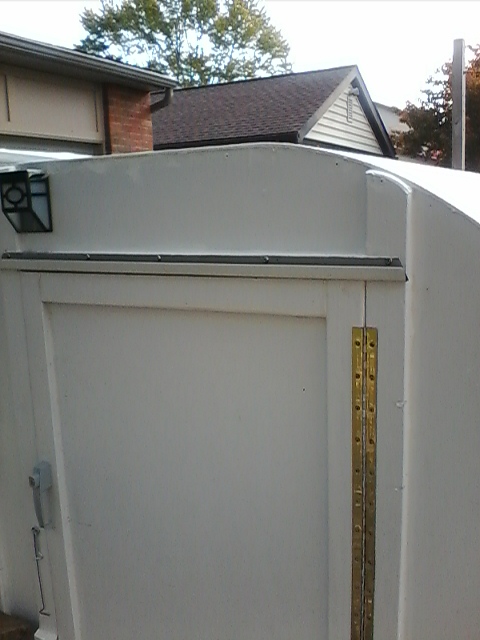

My doors turned out to be easy to make but they are square corners. I cut out the door from the wall. The outside of the door has a 'flange' of 1x3s about 3/4" over the edge on the out side. This overlaps the exterior wall. The door fits the hole in the wall it is cut from. A 1x3 is is placed as a vertical batten next to the door and secured to the wall. This vertical batten is then hinged to the 1x3 on the door. I used another vertical 1x3 on the latch side and a horizontal 1x2 on top. The latch is a $10 locking screen door handle from a home center store. I used an aluminum siding J channel for a gutter along the top 1x2. The doors do not leak in torrential rain on the highway or ever. This without foam seal as the labyrinth on the edges works fine.
I suggest using a 1x4 through the middle and cutting the upper third of the door to make a dutch door. :-) I wish I had done that but I was having enough problems getting my trailer finished while I had the energy.
I make note that I'm not a woodworker and have limited tools. I design things to be the fastest and easiest to assemble and still work. A crude hack really.
