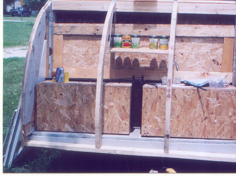

Re: galley hatch out of alignment
Postby bobhenry » Wed Mar 09, 2016 12:31 pm
I cut my ribs out of 12" deep 1 3/4" thick Timberstrand engineered lumber . Here is a pic of two of the four ribs.
WE laugh at spring back.
