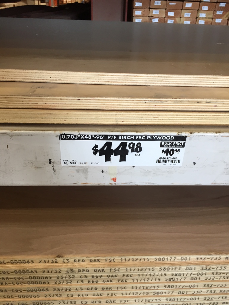

Looking to build my first teardrop style trailer and have a few questions. Been reading a lot and want to have painted wood sides as my finished sides of the trailer. No sheet metal, fiberglass just plywood. I would like to paint it with something to color match my Jeep Grand Cherokee though. So one of my big questions is what's the best word to use for the exterior finished side walls? Is 3/4" AC plywood fine structurally and cosmetically and weather wise? I live in Southern Utah and can't seem to find 3/4" Baltic Birch. Now Home Depot carries Birch but says they don't know if it's Baltic birch or not. And I have no way of knowing either. Anyone else know if it's Baltic Birch at a Home Depot? I know BB is the preferred type but can't seem to source it locally.

Is this birch at Home Depot the right Birch? Seems I hear it called "Baltic Birch" all the time. The Hime Depot employees didn't know and neither do I. It's super smooth on the exterior.

lacofdfireman wrote:Is this birch at Home Depot the right Birch? Seems I hear it called "Baltic Birch" all the time. The Hime Depot employees didn't know and neither do I. It's super smooth on the exterior.
I live three hours from the nearest Home Depot in a one-lumber-yard town. If I need two sheets of specialty plywood, my lumber guy will order it on Monday and it'll be in the yard on Thursday. Go check with a lumberyard.
What I'd be wary of is the glue used. AC plywood is really ACX and the X stands for exterior. I apologize for adding any confusion to the build process. :oops:

Do not use the plywood shown. It is prefinished and appears decent. Look at reviews on their site. I bought five sheets for trailer six, just as the reviews say, as soon as I cut it it warped! What a waste of time, lost the whole day precutting many pieces until I noticed. If you can afford it, go to a lumber yard. Oh yeah returned the pieces for refund
