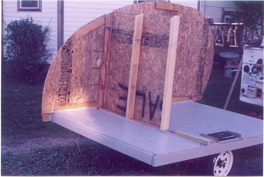

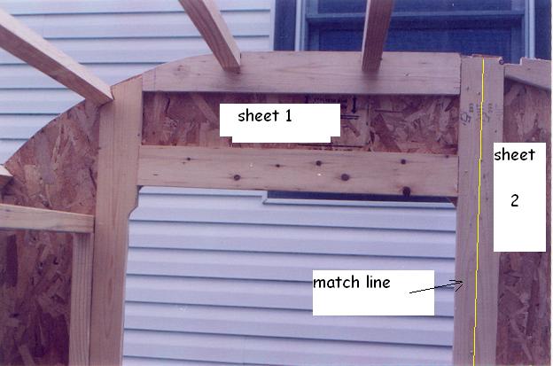

I measured and remeasured to get 3 vertical sheets to fall strategically so they could be reinforced with a 1x3 internal rib. Image
The galley wall was used as one splice and the door frame for the other. They can be drilled thru or simply saw out a portion if needed to wire.
When I veneered the outside I started with a full sheet at the rear and married the seams carefully one fell above the tire and the other above and below the door making them short and barely detectable. I let the veneer fly over the splices to help reinforce the entire wall.
