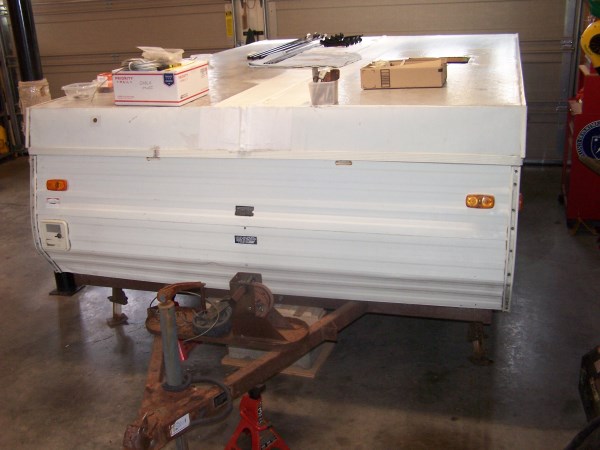

Postby les45 » Thu Jun 16, 2016 1:19 pm
Talia62 wrote:Except he said the stripe will be hammer texture, and the body will not. I'd say paint the stripe second, otherwise he will have hammer texture underlaying the white that he wants to have smooth.
Good point; thanks. I do have one advantage in that my painted joints will not be on adjacent smooth surfaces. There is a rolled joint on each side of the stripe on my sidewalls where the metal panels fasten together (the side walls actually consist of three metal panels that interlock at the edges). The panel that gets the hammered stripe was apparently covered with 15 vinyl pinstripes before it was installed and fastened to the adjacent panels. I'm using the hammered paint to partially cover some of the nicks and imperfections in that panel where I had to remove the pinstripes with a razor blade scraper and knife. The top stripe runs down the middle of the roof and will cover a 12" wide canvas tape that the previous owner used to seal the middle joint that runs the length of the roof. The tape is good and solid so I don't want to remove or replace it. The hammered paint will simply cover it up a little.
It's hard to see in the pic but there is a rolled edge on both sides of the center panel where the decals were removed.
It's also hard to see the tape in this pic but it runs the length of the top down the middle. It also gets the hammered paint just to try to cover it up a little.
