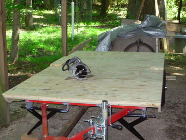

+1 on KC's comment. I cut small strips of wood and glued them to the plywood. Also drilled holes in plywood for the bolt heads. Located holes by placing plywood on frame with clamps and then using a hammer to beat on each bolt head location. The bolt head leaves a dent in the wood. Flip the plywood over and drill the bolt head dents in the wood with a 1" spade bit.

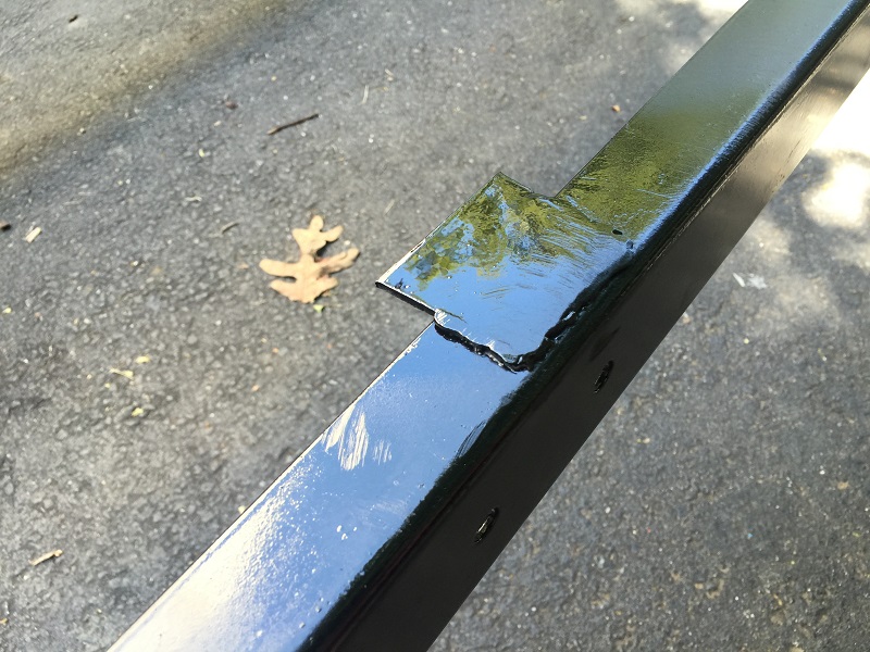

I welded on 1/8th metal tabs on the inside cross members, then painted.
