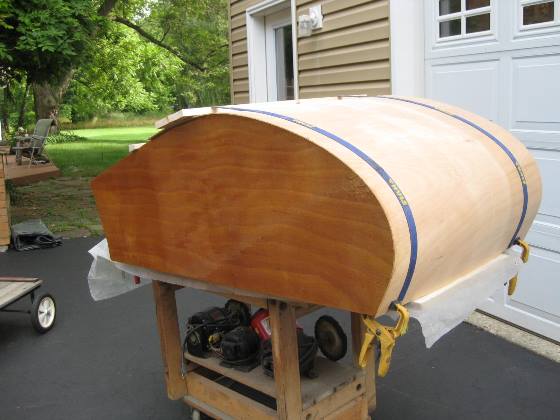

I'm a little late to this thread, but I'm doing it now at home. You can see pictures in the build journals, "Cargo Woody Tear". I'm not going to glass the curved top before installation because I'm pretty sure that would make bending the ply way too difficult. I will epoxy the inside at installation (today) and glass the outside afterwards. All the flat panels were constructed level on a table to reduce drips and runs.
3mm bends pretty easy here
IMG_test fit.jpg (43.46 KiB) Viewed 540 times
