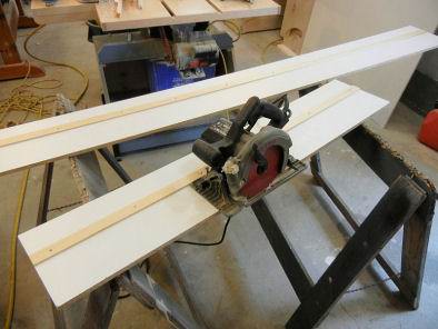

Postby greygoos » Mon Aug 22, 2016 5:14 am
track saw.jpg (20.7 KiB) Viewed 2081 times

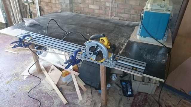

Postby UK-Corlett » Mon Aug 22, 2016 8:41 am
Hi sxjames
drives you mad doesn't it.
I cured my wows and got this, I guess Dewalts EZsmart. It cuts so straight and clean; it cuts up against a rubber shield which stops it blistering. Its quick too, cuts trimming time enormously. Here in the UK wasn't cheap though.

Postby tony.latham » Mon Aug 22, 2016 10:19 pm
greygoos wrote:http://www.ibuildit.ca/Workshop%20Projects/Shop%20Tricks/tricks-18.html
I use the same system. Cheap and accurate. Works like a champ.
