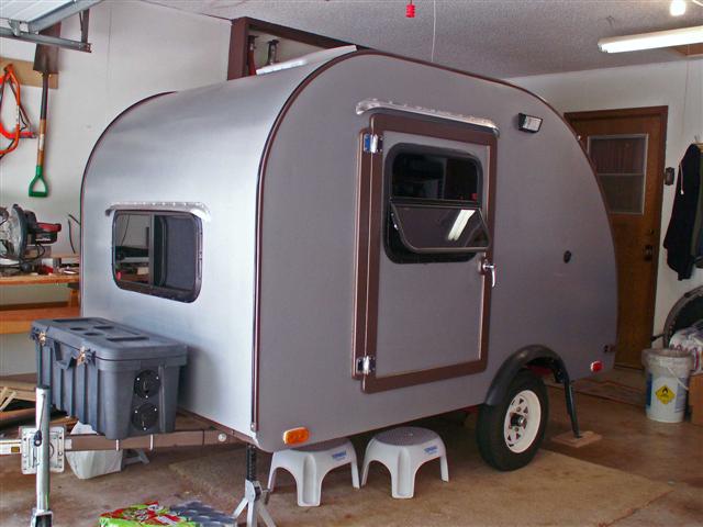

You can find crank out windows suitable for a TD at reasonable prices if you are patient. I found crank out Hehr windows for my doors and a Hehr wide/narrow slider for the front on Ebay and they all have screens. I think I paid less than a hundred dollars for all three including the shipping. They have worked great and are bug free. The front slider will allow water to get in in a windy Oklahoma thunderstorm, but the door mounted crank outs have done the job. Of course they were used and I had to do a little frame straightening using C-clamps, but it was an easy job and they look like new.

I have aaalllll winter to find some ;) Those are really nice! Thanks for the name, I'll keep a lookout!
