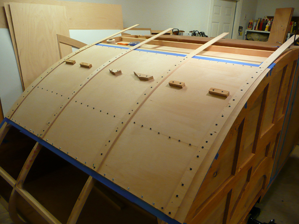

Here's the hatch on my TD. You'll notice the two strips of plywood running top to bottom to help stabilize for handling until I get the outer skin on.

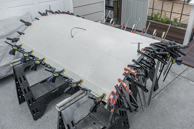

I removed the plywood strips, set the hatch up on my saw horses, glued, clamped and nailed the plywood outer skin. It went on great and should be as perfect as the rest of it.
Hatch Clamp.jpg (244.34 KiB) Viewed 1601 times
After the glue had dried overnight I removed the clamps and placed it onto the TD. WTF, something wasn't right, it felt like it was hitting on something.
After examining everything possible thing I determined that it was so warped that it just wouldn't close. It's a little over a half inch away from the TD on the bottom left corner. :cry:

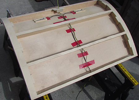

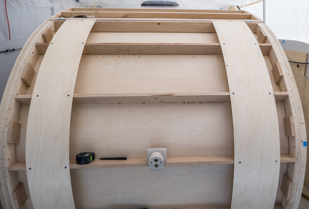

Here's a photo on how I make my hatch lids.
The 1/2" ribs are 6" apart.
The blocking between ribs is structural and also a place to mount paper towel holder, lights, etc.
The blocking in each corner really adds to the stability of the lid.
Hope this helps, :D Danny

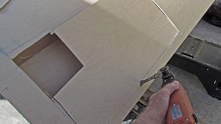

First step was to mark out the edges of the hatch frame so I didn't cut into or through them.
Hatch Fix 1.jpg (160.21 KiB) Viewed 1308 times
Next I started cutting out all the plywood in between the frame using my multitool. I cut inspection holes ever so often to make sure I wasn't running into anything.

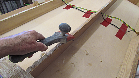

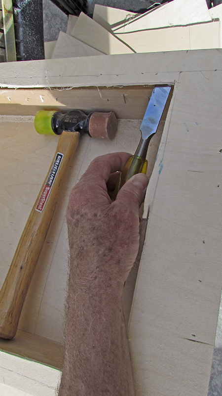

Then I started working my way around all the glued plywood with a hammer and chisel.
Hatch Fix 4.jpg (307.93 KiB) Viewed 1306 times
It made a pretty good mess and it wasn't pretty but I got it all off.

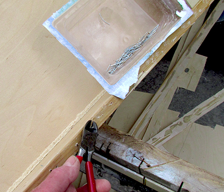

With a big pair of wire cutters I removed nails for the next hour!
Hatch Fix 6.jpg (205.55 KiB) Viewed 1305 times
