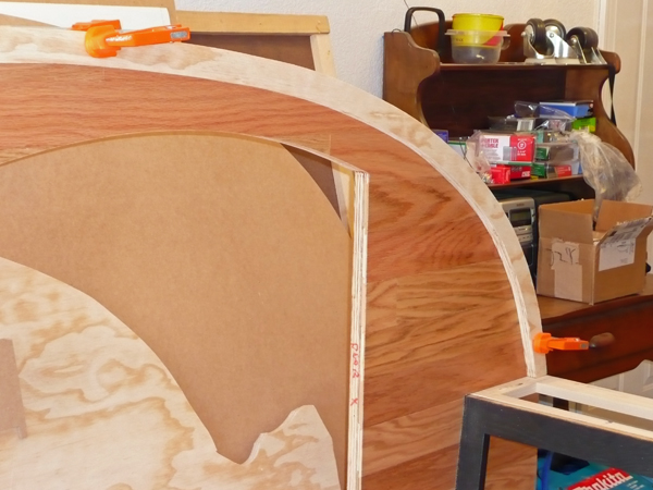

A butt joint for something so critical makes no sense to me. I fall into the sandwiched-wall crowd and cut a mortise into the wall. It's not going anywhere.
Here's my wife and fellow teardrop builder working on a wall. You can see the mortise cut into the 3/4" skeleton. The oak spar is fitted and then glued in place.
Brute strong. :thumbsup:

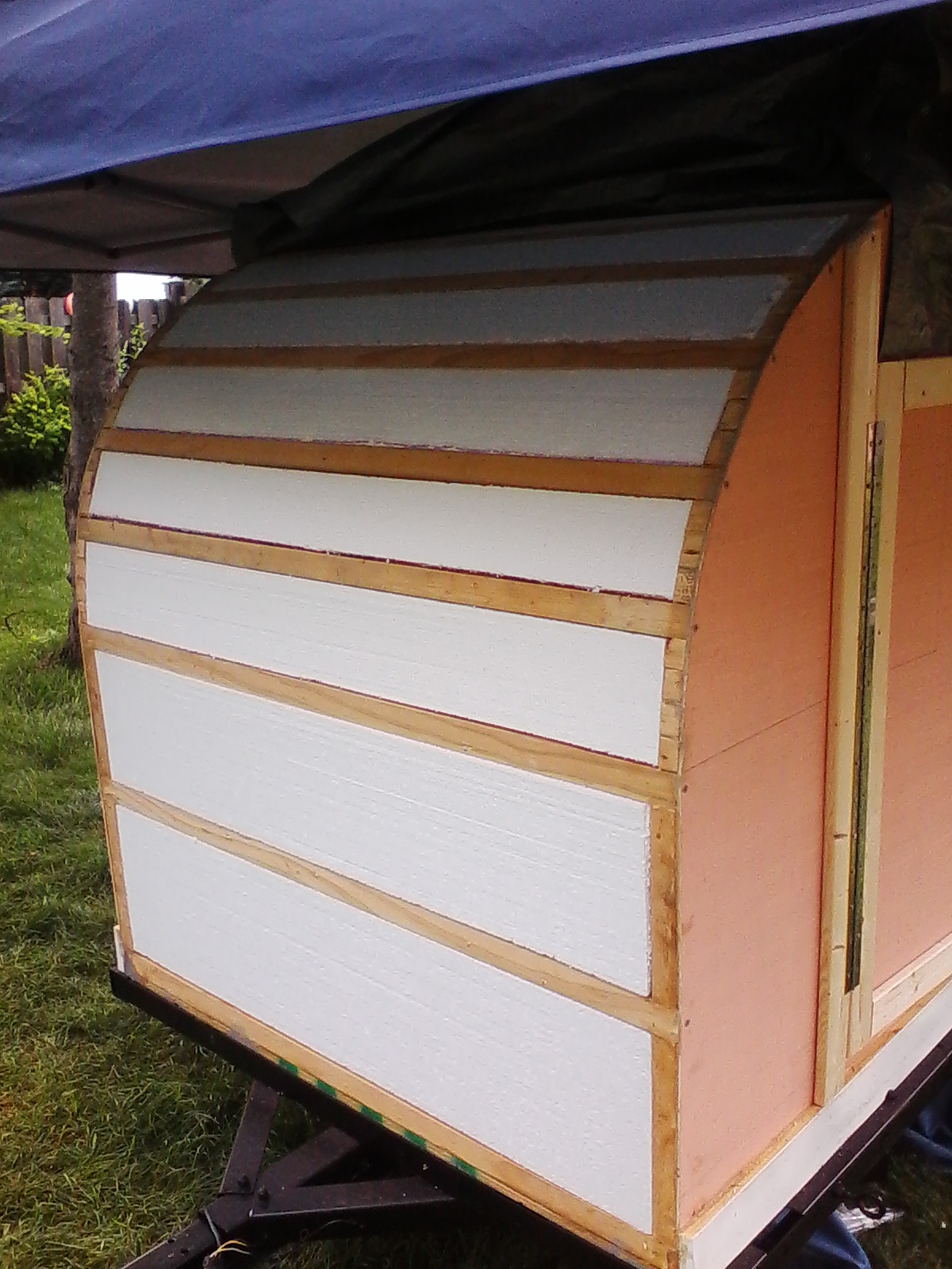

Sandwich wall construction, butt blocks, screws, glue & skins. Not going anywhere, ever...
Rout rabbet joint into wall panels after interior skins are in place & finished
Ceiling skinned (pre-glued canvas headliner) & spars fastened in place. Everything is glued.
Image[/URL]
Blocked edges & insulated with 2 layers of 3/4" foam for the headliner, prior to skinning exterior
