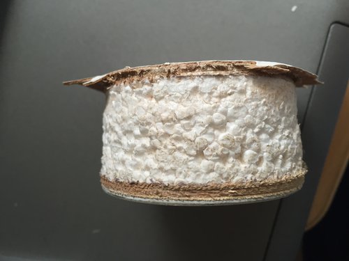

We were in the same situation as you, my wife is disabled from neck surgeries and has no upper arm strength so wanted something that was a bit easier to move. We looked at a lot and found the Little Guy T@G worked for us. It is 870 pounds before you add battery/propane/water. Ours loaded with underbed storage and kitchen stuff, Norcold full of food, dual batteries, larger toolbox is 1050 pounds. We do not load anything in the cabin as we like to be able to stop and sleep without unloading everything into the TV. This is a picture of the wall, thin clad over 1 1/2 inch foam - extremely well insulated for cold or warm camping. LG has a video walk thru on their web site.

Foam sandwich construction as listed above will definitely safe you weight. my 5x10 home built tear is about 900 lbs camping. I do need to weigh it to confirm, but the shell was 300 lbs before I put it on the trailer frame. foam sandwich is strong and light, see my avatar photo for an example of what 1 inch of foam and 2 sheets of 3mm ply can do. I am 180lbs and I am standing on a 14 inch cut out for the roof vent.
