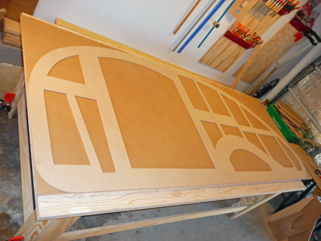

Postby aggie79 » Tue Dec 20, 2016 11:34 am
Although my teardrop is not a woody, I did something similar to what I think you are wanting to do to create a 1/4" MDF template to layout cuts and as a router template to cut the plywood "framing" for my sidewalls. 1/4" MDF works well as a template because it is typically 1" longer and wider than standard sheet goods. This is a picture of the template on top of 3/4" MDO plywood:
To answer your question about maintaining a parallel cut around the curved perimeter and other radius cuts, this is how I made my template. First, I drew a 3" grid. Then I started to draw the perimeter. For the straights, I marked all of the exterior straight lines on the perimeter and their starting and ending points. Then I marked the interior straight lines at the offset that I wanted. I did not mark the starting and ending points of interior straight lines. Next I started laying out the exterior curves and radii. For the radii, I used a home-made compass/trammel to mark the exterior radii and interior radii (at the desired offset). I drew the radii beyond their intersection with other curves/radii.
This is how I drew the exterior perimeter curves for the "non-radius" other curves, I eye-balled the curve and used a batten and hard points held with double-sided tape. I moved the hard points around until the curve was looked right and the starting and ending points were tangent - blended smoothly - with the previously drawn straight lines and radii.
To draw the interior curves, I made a home-made version of this scribe tool: https://www.amazon.com/M-Power-Perfect-Butt/dp/B001BLX1GM. I don't remember my offset distance, but I think it ended up being about 3" - 3-1/4". To make the tool I used a 3-1/2" hole saw and cut a "round" in 3/4" plywood. I believe the hole saw has a 1/4" pilot hole. Whatever diameter it was, I wrapped tape around a pencil until it was just snug. Then, using the tool against the batten, drew the offset interior curves. (Intermittently I removed a hard point and/or blended in the line to make a continuous line).
To cut the template, I rough cut near to the lines using a jig saw. I then used a sander and/or hand-sanded to the lines for the finish cut.

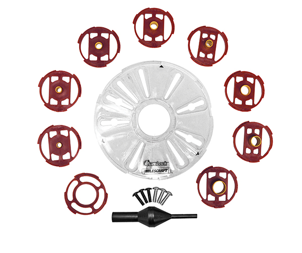

As another possible option, take a look at the Milescraft Base plate/bushing set. The clear base screws into the bottom of your router and you use interchangeable bushings. You may not even have to remove the router bit to change bushing sizes if your bit is small enough:
https://www.milescraft.com/product/baseplatebushingset/

Postby QueticoBill » Tue Jan 03, 2017 8:22 am
Good concept but I'm looking for up to 3 1/2" offset, and this is not 1/2".

aggie79 wrote:Although my teardrop is not a woody, I did something similar to what I think you are wanting to do to create a 1/4" MDF template to layout cuts and as a router template to cut the plywood "framing" for my sidewalls. 1/4" MDF works well as a template because it is typically 1" longer and wider than standard sheet goods. This is a picture of the template on top of 3/4" MDO plywood: ...
You did a nice job on the template Aggie... :thumbsup: :thumbsup:
And of course, the trailer turned out equally as nice... great job... :applause:
Sorry to jump in on your thread Bill, but I had to comment on Aggie's template...

Postby QueticoBill » Tue Jan 03, 2017 8:18 pm
Not a problem AZ. I studied the pictures quite a bit.
