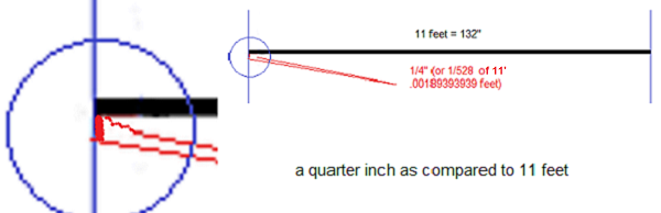

Postby working on it » Fri Mar 31, 2017 7:40 pm
Woodbutcher wrote:I would say a 1/4" in 11 feet should not create any problems. When questioning things like this as a youngster my Dad would always say "We're not building a watch" . So as I grew up I realized everything will not come out perfect. As an old guy I now adjust in the field when things don't go just right.
MtnDon wrote:...Myself, I think 1/4" in eleven feet is a large error....
  • Unless you compound the error, by adding to it or overcompensating for it, none will be the wiser.
  • Have you ever re-built an American car from the 60's or 70's? The panel alignment and gaps between panels were sometimes atrocious; but, unless someone was trying to spot the differences from side-to-side of a car, or measuring the gaps, one side could have bigger gaps than the other. You really can't look at both sides at the same time! If each side was singularly symmetrical, then it was fine. And, as I always heard among the old guys: "if It was dark, and raining, and you drove past 50 yards away, at 50 mph, then just about anything looked good". My Chevelle was/is such a car, and maybe my TTT, but the little imperfections give them character, and make them unique.
    quarter inch compares to eleven feet.png (40.28 KiB) Viewed 635 times
