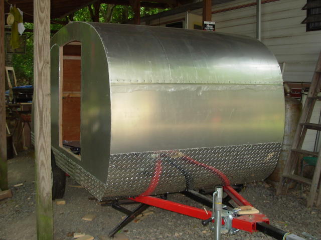

I faced the same dilemna when building my TD in 2006. My sidewalls are 53 1/2 tall including the shroud around the floor framing so my 4' wide 0.040" aluminum sheets did not quite reach. I bought a sheet of 0.063" diamond tread aluminum to use as trim on the sides, & as a rock guard on the front. I overlapped the 0.040" siding a couple of inches on the sides & on the front & drove #6 stainless screws every 2" on the front & every 2 1/2" on the sides (botttom of the side trim was screwed every 6"). Before driving the screws I put 3 beads of PL 1200 adhesive on the 0.040" aluminum siding, & around the perimeter of the trim pieces & the rock guard. I drilled a pilot hole for the screws & after setting the screws in place I removed them, squirted some PL adhesive in the holes & re-seated the screws. 10 years & close to 30K miles & there've been no leaks that I'm aware of... I think using a good sealer between the diamond tread (smooth side) & the 0.040" siding should give you a good seal. My rock guard (& the side trim pieces) go up & over the bottom of the aluminum siding & the seal is still good.,

Yes, good idea on the flashing. I'd bought some 0.020" 'valley flashing' to 'edge' my doors but never thought to use it under the 0.040" siding before adding the diamond plate trim :( . Fortunately the adhesive beads have worked well on my build but if I were doing it again I'd add the flashing. A 20' roll of valley flashing, 12" wide is just a few bucks at our local Home Depot, & I'd expect it's available at most 'big box' home stores...
