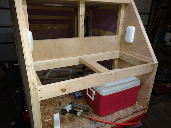

I am looking for suggestions on my hatch. I would like the hatch to fold down and then i'm not sure about the spot where my cooler would go. I would prefer it to be a seperate door from my hatch door but i am just lost on ideas of how to do it. If you have any suggestions it would help a ton! Thank you!

If you don't mind having a divider or even just a stile, you could do mini barn doors on the lower face, perhaps with a slide out tray on heavy drawer extensions. This seems to me to be the easiest/most efficient way to seal and latch the lower section, and would allow either door to open independently (as opposed to doors that overlap).
The upper hatch could be extended just enough to act as a drip edge for the lower doors, but would seal independently so that you don't necessarily have to open it to allow either of the lower doors to open.
How did you intend to seal the hatch along the counter edge? I don't see any provision for that in your current arrangement, unless you planned on having an angled lip on the lower edge of the upper hatch so that there is a spot for a weather seal to land on the upper edge of the counter rail.

That was my idea, Put a bit thicker Counter top on it and have it the same angle as my back hatch with weather seal attached to the hatch itself so when i close it, it will seal it. If that makes sense?

If your cooler is going stay in that arrangement how about accessing it through a sidewall door instead of the hatch? To get to the contents, you could put the cooler on a slide-out drawer.

We have the same cooler location, drawer slides (full extension) were used to make access easier. Just a simple shallow box, which allows the cooler to sit & be held in place when travelling, then it slides out for access to food.
It's a lot easier to have a hatch lift up & provide shade when cooking than have it drop down in actual use. A bit more work & planning, but worth the effort when it's done. Just sayin'....
