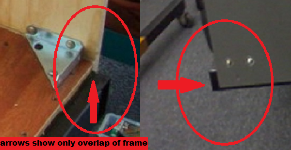

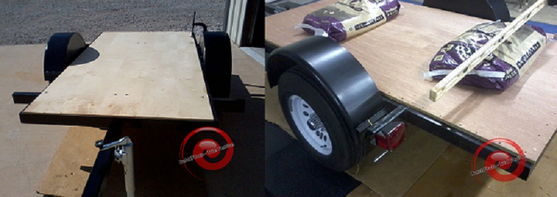

  • I was building with weather exposure in mind, and ease of checking on and/or repairing of future potential water intrusion. I started with a 50"x60" frame, welding on one foot in front, and two feet in the rear to increase the frame 'platform to 96". I placed the first sheet of 1/2" birch plywood on the frame with the front recessed 3/4" from the edge, and the rear all the way to the edge of the frame. A vertical front wall was to be placed directly on the frame at the front, while an overlapping vertical hatch door would close against the rear edge of plywood. PL Premium adhesive sealed all wood to frame contact points. the plywood sheet, centered from side to side, left exposed frame and exposed plywood edges (to be sealed later with poly "mix", straight polyurethane, and finally multiple coats of acrylic enamel -for waterproofing). After the 1/2" sheet was carriage-bolted to frame crossmembers, a 1/4" luan sheet was glued to it with Titebond2, pressure-rolled, and Tek screws were installed thru both layers of wood into the frame, all-around the perimeter. The finished flooring was given the complete poly treatment.
    frame exposed all around.png (405.79 KiB) Viewed 842 times
  • The 3/4" front wall of the trailer rests on top of the frame, sealed with PL adhesive, and there is a thin steel plate glued and screwed to the outside surface, that drops down over the wood-to-frame interface, to protect it from highway speed-induced debris, and forced water intrusion.
    frame overlap.png (197.38 KiB) Viewed 842 times
  • As I stated, I intended to leave all other plywood edges either exposed for my future care, or directly sealed to other plywood surfaces. That said, I then put the rear bulkhead, and the 3/4" vertical walls sitting, and completely sealed to, the top edge of the plywood floor. The roof pieces were placed on top of the walls, with its plywood edges also exposed, and they were sealed in the same manner. All joints and seams were then also sealed, inside and outside, with more PL, and later the poly and paint. P.S. all exposed hardware was sealed, and the holes drilled to install bolts sealed, usually with PL, or with UV-resistant clear acrylic enamel.
  • I think I sealed it pretty well (except for the canopy dumping water onto a not-completely-shut door-seal!), but to do so, required that the interior width was only 46.5" (which negated a plan to install a 48" wide front window I had already purchased), while the interior height stayed a full 48", but it was a change in my original plan, that I thought would be better for later inspection and possible touch-ups. Besides, I thought that the exposed frame was a plus factor for a nuts-and-bolts guy to show off.
