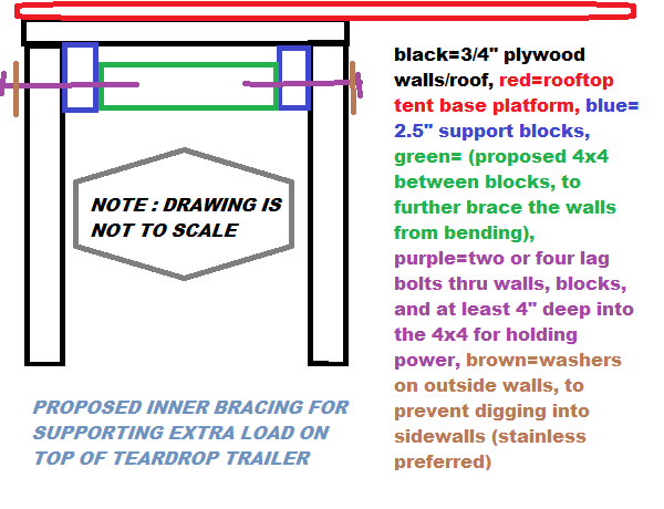

  • I'm also looking to add extra bracing to my 3/4" walls, both for making a roof rack support, later on, and an inner brace/weight support for the interior (I need to make an overhead lift "trapeze", since I have trouble getting out of bed- can't roll out!) My roof is bolted/glued directly on top of the walls, and needed no spars to support it, as it is well-supported all-around, and is of small overall size. I want to retrofit a 4x4 spar/beam , glued to the roof with PL Premium, and using long lag bolts to affix it to the walls. I'll cut it to 46.5" long (wall-to-wall dimensions), carving out a 2" wide center space (so it will fit over my central light bar on the ceiling), and using eye-bolts to tie my lift rope to (soft, braided 3/8" marine rope). Of course, painted to match the decor! You might consider something similar, though it might be better to lower the beam's height (as low as you could), to make a stronger bracing structure.
    BRACING PROPOSAL.png (23.83 KiB) Viewed 2379 times
