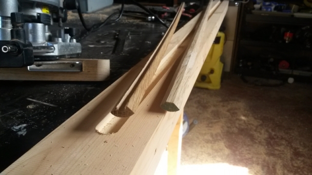

Hi all
I am not a fan of running wiring inside the walls and my wife hates to see wires at all.
I have solved this conundrum with Oak Cable Trunking.
Basically running a router down the back of 1/4 fillet Oak Molding. You can See I made a tool to hold the trunking while being routed. So the wires run in the groove.
