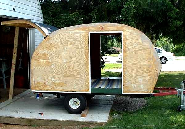

Do you think the door bottom can be too low? This is of course can be constrained by the door height, but if that is not set, what are the negatives of it being lower, particularly home built doors?
Teardrop door.jpg (75.91 KiB) Viewed 1317 times
QB
QueticoBill
Posts: 1215
Images: 22
Location: Clayton NY

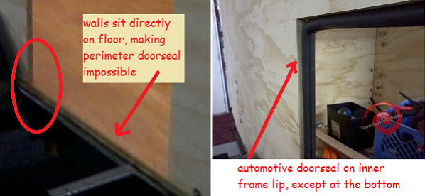

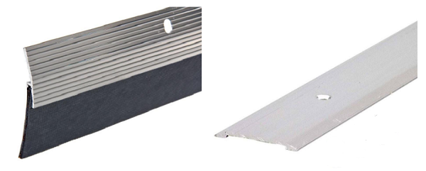

Postby working on it » Fri Jul 14, 2017 1:53 pm
QueticoBill wrote:Do you think the door bottom can be too low? This is of course can be constrained by the door height, but if that is not set, what are the negatives of it being lower, particularly home built doors?
  • The OP was asking about door height using pre-made Challenger doors, which I assume come mounted in a full perimeter frame. With that in mind, there would have to be a wall surface of sufficient height above the trailer frame to bolt/screw the doorframe to. That would limit how low the door can be. In QueticoBill's case, and the same goes for my trailer, the doors can go lower, either resting on the trailer frame (I assume using a water-resistant threshold) or at least a door sweep, to deter water intrusion. A standard rubber weatherstrip wouldn't work, in a small TD or TTT, because of contact with an occupant's derriere, when entering or exiting thru a short door (especially in a 4x8). Larger door sizes, in a standy or cargo conversion, would pose no need to enter while sitting down, so a full perimeter doorseal could be used.
  • 102813105587 doors go to wall bottom, 3/4" above frame (resting on floor)
    door sweep and threshold.PNG (111.45 KiB) Viewed 1296 times
    pieces used in lieu of full perimeter doorseal
    door and automotive seal.png (258.52 KiB) Viewed 1293 times
    upper door uses rubber seal not possible at floor
173193172890148599
working on it
Posts: 2189
Images: 457
Location: DFW Texas

Postby working on it » Fri Jul 14, 2017 3:12 pm
QueticoBill wrote:I was looking at a "lip" that over hung the floor edge and chassis.
That's why I used the raised curve of the threshold to create a slight friction-fit with the door, and use a stiff vinyl door sweep to create on overhang to seal off the threshold/door from water being blown in, or thru surface tension. My 3/4' thick floor sits on the trailer frame, and the sweep overhangs it by 5/8", leaving an 1/8" gap above the steel frame (the 48" wide floor/deck is centered on the 50" wide trailer frame, so 1" of frame is exposed, preventing further overhang depth). Your walls seem to extend fully to the edge of your frame, so you could have even greater overhang than I. I could install a wider threshold to extend to or past the steel frame edge, and have less chance of water intrusion from surface tension, but but what I use now has worked so far...if I remember to fully close my doors (and don't let the canopy drain directly onto upper the door seal, when slightly ajar).
173193172890148599
working on it
Posts: 2189
Images: 457
