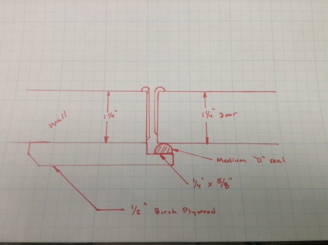

Here's my starting point for the doors. I have a few questions before proceeding, and was hoping to get some advice from folks who have already built their doors in a similar fashion.
door frame sketch
Door material - Should I use 3/4" birch plywood skinned with 1/4" birch ply to build the door or use the same sandwich technique that I used on the walls with 1x's skinned with plywood.

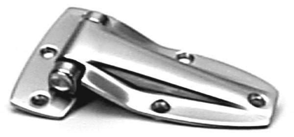

Hinges for the door - I've considered using stainless steel strap hinges like these
ss strap hinge
or should I use a stainless piano hinge? Pros/cons?

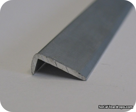

Trim - Considering using something like this to trim the outer edge of the door and the door frame
trim

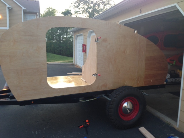

Postby kokomoto » Thu Apr 27, 2017 9:14 am
Side pic 1
