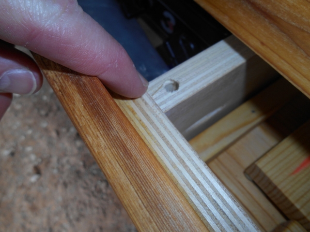

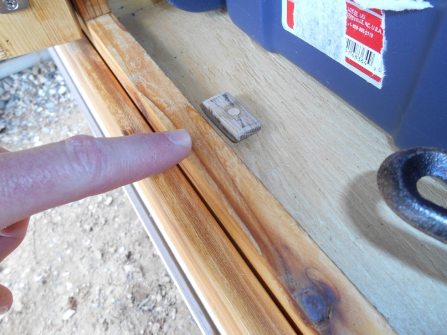

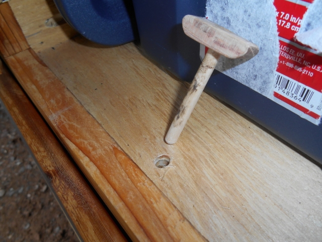

This probably isn't what you are after. I just thought I would throw it out there as an option if you can't find what you are looking for. Kind of a DIY style solution. I've seen many creative examples of this type of pin on t&ttt...

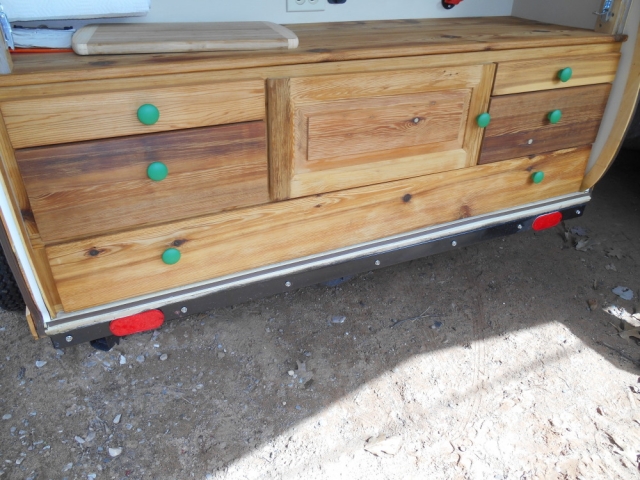

I have a very wide drawer in my galley.
I had trouble with it extending anytime the TD wasn't sitting level. So I created a pin which is hidden in the cabinet above the drawer.
It was quite simple to locate a pin that would lock the drawer closed when needed. It is aligned with a divider in the drawer below.
A shot of the hole that the pin drops into in the divider in the drawer. Works pretty well.
