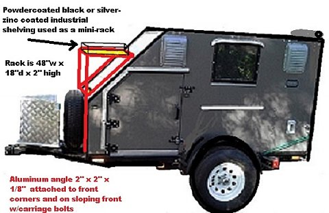

  • If I used 1/8" thick aluminum angle to build a simple framework, the colors of shelf and framework would fit in with my low-tech scheme, require few more holes in my trailer (less tan a rooftop rack, or my awning scheme), and have suitable attachment points for the intended load (two 45 lb canopies), and the open wire mesh would have good drainage.Since I'm trying to keep all my trailer weight as far forward as possible (I built it too heavy in the rear, with A/C unit, an on-board generator with extended run fuel supply, and cooking and lighting gear, back there. Lashing my canopies to a front rack, will help balance it even more so.)
    proposed industrial shelf as a mini-rack.jpg (37.79 KiB) Viewed 1879 times
    rough drawing of simple mini-rack & framework

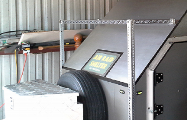

  • I received the wire shelf yesterday, and gathered all my parts together. I found that it was rather difficult to measure, mark, and position the 15 lb. shelf where I wanted it, with only one arm able to work alright (bad thumb and rotator cuff injury on my left arm). But, I figured out the general locations and marked them ok.
  • Today, I started by placing the wall/front slope clips in place, on the 45 degree front of the trailer, and snapped them over the bottom rear edge of the shelf, to hold the shelf in place, so I could measure ans set the support arms, prior to cutting the slotted angle. After the angle stock was cut (2 x 32" each), I drilled out the corners of the front of the shelf, to accept 3/8" bolts (the nominal size of the slotted angle holes, too). With eah front corner drilled, I attached a slotted angle piece to both, then lifted one side at a time to "level", and used #9x1.5" Simpson Strongties structural screws to fasten to the trailer front wall. The screws were used because there was insufficient space to use nuts and bolts (I could've drilled the holes, inserted the bolts, but not the nuts). So, I used the screws with bonded rubber/steel washers under the angle, next to the wall, to prevent water intrusion (I used the same washers under the clips, with 10-24x 1.5" stainless bolts and nylocks).
  • Tightening down the rear clips was the hardest part of the job. Inside the cabin, hanging from the front slope, is a wooden shelf for my cooling fans (3), stereo and speakers (including hidden marine antenna), LED lighting (one of three sets in the cabin), and all the associated wiring. I could barely reach inside, to put on the backside washers and nylocks, kneeling on the mattress, and had to wedge the bolt heads to keep them from turning, while I tightened the nylocks from inside (if both my arms were working, it wouldn't have been a problem. Tightening these four took me four hours! After that was done, I used left-over angle to reinforce the support arms, by bolting a second thickness inside the supports. I don't expect any problem with them, but extra strong is better anyway.
  • I spent $14 for one 60" angle (I already had one on hand), and $19 for the shelf (Amazon Warehouse deal -like new, in original box-, and I already had the steel clips, and the other hardware I needed. Total cost, $33 (probably $60, if I had to buy everything). Not fancy, a rudimentary design; but it's just what I was intending to make, for a specific purpose. I'm not going to paint it, the zinc/stainless look will weather fine (it sits in the garage between trips anyway).
    rack 1.png (468.71 KiB) Viewed 1874 times
    48x18 shelf, to serve as a rack

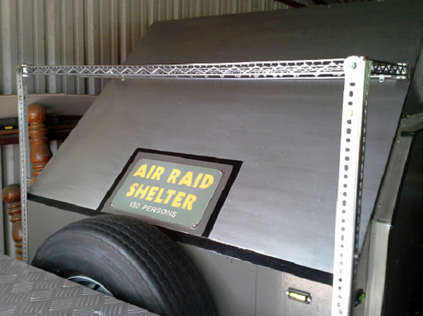

    rack 2.png (379.19 KiB) Viewed 1874 times
    zinc/stainless/aluminum theme all over

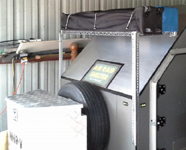

    canopies strapped to rack.png (445.94 KiB) Viewed 1874 times
    specifically made for my two canopies

  • True, my trailer isn't the most beautiful one out there, nor was it ever intended to conform to any conventional design...it is what it is, an attempt to pack in the necessities for one-person camping, in or out of the usual camping locales, on or (slightly) off-road. The "attempt" is a continual process, and I modify the trailer to meet my needs, or at least try, between every outing Some mods are better than others, and remain, while others are less successful, and are discarded.
  • My latest modification, a front rack, made from cheap and/or re-purposed leftover materials, is a logical (to me) step towards my goal of being ready to pack up and go, in an instant, without finding space to stow my gear, or having to check for what is and isn't aboard. Not satisfied with just having my canopies stowed on the new rack, I decided to add bracing with more leftover scrap, so I could add a folding chair (in a bag) on top, bringing the total suspended weight to 100 lbs.

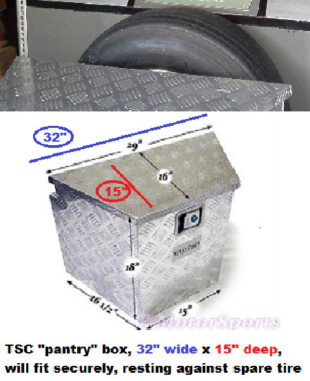

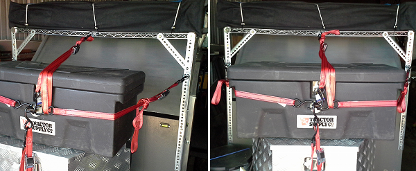

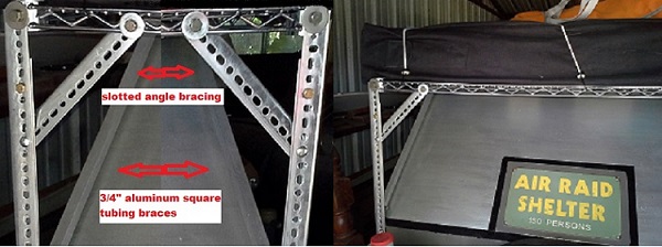

  • After the rack was braced to my satisfaction, I thought that the flat top of the tongue box would make a great spot to carry my pantry-in-a-box (a Tractor Supply storage box), provided that I add tie-down locations to the rack. I added three D-rings to the reinforced rack, and added a forged 3/8" eyebolt to the TSC box as an attachment point for motorcycle straps, and voila...my pantry will be ready to go, whenever I need it (it is always stocked with Spam, beans, and greens for two weeks, and I can carry a small bag of perishables in my truck, from my home stores).
  • When I built the trailer, I made the front slope at 45 degrees, to lessen wind resistance. That was when I thought my HHR Panel would be the tow vehicle, but my TTT, now at 2000+ lbs, was too heavy for it. I use my Chevy 2500 HD pickup as my TV, and wind resistance of the trailer doesn't matter, at all, so I can partially block the sloped front, with no deleterious effects. And, there is still an air gap allowing flow up the slope, anyhow, if ever I get a less capable tow vehicle.
    upper and lower bracing for rack.jpg (63.23 KiB) Viewed 1687 times
    used scrap metal to reinforce the rack for extra loading
    pantry box secured on tongue for travel.png (331.77 KiB) Viewed 1687 times

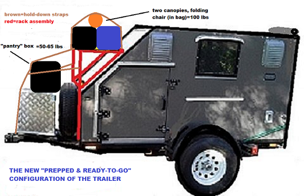

  • My wife just asked me why I keep on changing the configuration of my trailer (I no longer hold any hopes of her using it, though I designed it for her use, at first). She doesn't understand why I must modify things, constantly, when nothing is really wrong with them. I changed my load and loading procedure after every drag race I participated in, for years, never getting it "just right", even after two decades (trying to cover all eventualities, but keeping it simple and fast to load up). But, it never worked out for me, since I had to load from scratch, and completely unload after coming home, because I had no enclosed space for truck, trailer, and gear (only the race car got covered in the garage. I loaded boxes of tools and gear, only having to remove it all, before going to work. It wore me out, eventually, and I don't miss the racing much, because of the hassle. If only I had everything ready-to-go, at all times!; it would've been a joy, comparatively.
  • Now, I don't race anymore, but I've switched over to camping, and the outdoors, having retired 17 months ago (I started building the trailer 68 months ago, in anticipation, and have been using it sporadically, for 45 months). And I have the same problem, packing up for a trip, setting up once there, and unpacking back at home. Admittedly much easier, since meeting my living requirements for camp are much less than for supplies and tools for my race car (and for much of my team's cars, as well). I don't have to unload the trailer from the trailer, as ridiculous as that sounds; it just gets stowed in the garage, alongside the unused Chevelle. But, the gear sitting uncovered in the bed of the truck remains, and I'm not as mobile as I once was, so I've put everything I could, into weatherproof storage boxes, again.
  • My trailer sits loaded, in the garage, with water, a Coleman folding chair, and side tables and side tents inside the cabin, strapped to the front wall (using an E-track system), with only the rear ice chest waiting to be loaded (I keep the cold/frozen meats and perishable foods there, in the "galley"). But, I was still having to load up my canopies, other chair, spare fuel, porta-potty and spare supplies for it, and my two other coolers, into the bed of my truck. Also, tools and parts that I like to carry, in addition to those in the truckbox and trailer tonguebox. And, my EDC box, with get-home bag and certain supplies, that goes with me in either of my vehicles, whenever I travel 50 miles out.So, it seems that I am in the same situation now, packing for the outdoors, as I fell into while packing for racing.
  • I have just made a functional, but not pretty, rack, to hold the canopies and extra chair, and attached my pantry box to that rack, sitting on the tonguebox. I strapped it tightly to four points with motorcycle straps...it's not going anywhere; I always put it on my tailgate or on a side table at camp, so it's not in my way, in this location. I've decided to leave the extra toolbox in my truck, fulltime, and the light EDC box, moves from one vehicle to another, as needed. Just the fuel, porta-potty equipment, and coolers need to be unloaded, now, but since they are all waterproof, it won't be a pressing need, anymore. Slowly, but surely, I'm getting closer to the goal of instant readiness, but a dedicated outdoors vehicle and a 12v-120v cooler (or two) are still on my wishlist.
    securing the pantry for travel.png (203.31 KiB) Viewed 1660 times
    rack provides secure carry of pantry, also
    storage boxes always carried in truck bed.png (142.25 KiB) Viewed 1660 times
    extras now stay in truck bed between trips
    PREPPED & READY.png (374.36 KiB) Viewed 1660 times
    getting closer to instant readiness
173193172890148599
