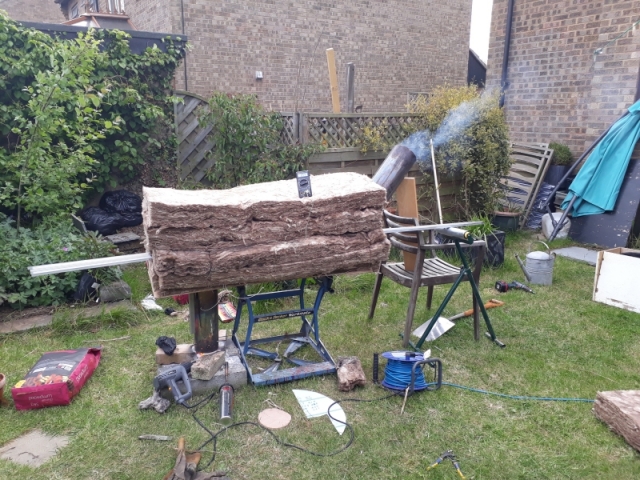

I am starting to clad my TD in Aluminium and wanted to share my annealing oven.
Here in the UK extruded Aluminium is supplied in 2014 Grade, I can't find the US equivalent but essentially its a 3.9-5.0% copper alloy.
But its too strong to do anything with in the as extruded state. So I have annealed mine with great results.

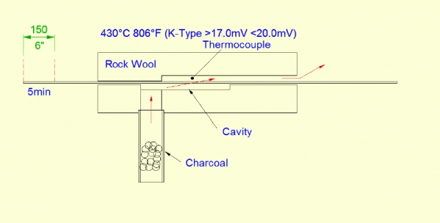

The Idea is to put the copper in solution and to do this you need a high temperature approx 430C (800F) for 20mins.
Well 430C is quite hot, so I went for an oven supplied this heat from charcoal.
You have to let the charcoal calm down and stop smoking also my small tube only lasted half of the run so I have to re-fill and continue.
I got hold of an old K-Type thermocouple to measure the temp reading it off my old volt meter, 17.5mVolts is ideal. I pushed an extra 6" in every 5 min.
As you can see it all went well .

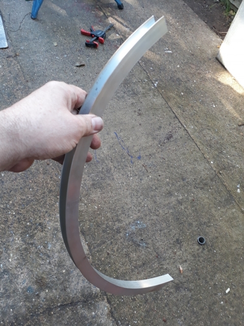

Once the annealing is over these kinds of bends are possible. This is a 1"/1" U Section 3/64" thick.
This is my wheel arch trim. No buckling or stretch marks.

Cool. How do you do the bend?

Hi Edgeau
I have a roller stand the type of thing that supports long lengths of wood for a table saw.
I rolled it back and forth like using an "English Wheel" using a cardboard pattern for shape.

The use of the oven allowed me to pull 7 lengths through at once. so Although it took a couple of hours all were done at once.
As the material is slowly removed from the oven it cools down slowly which looks to be very important.
One bag of charcoal cost £5 and a bail of rockwool £20. I guess that could have bought a lot of gas.
The issue I had with flame annealing was also the inconsistency of the anneal along the length of the strip.
Dislocation Theory - In a normalised regular aluminium crystal lattice the atoms can move over them selves easily because of small faults in the lattice. Working the material resolves those faults and it becomes harder to work "work hardening". You can introduce single crystals of copper into the lattice it too prevents the aluminium lattice from moving. However the copper can be put into solid solution and effectively removed from the lattice. Further heat treatment and or time can precipitate out the copper returning it to the lattice, "Age hardening".
Classic use of this is aircraft rivets, solution treated to be soft, pulled into the air frame where they rapidly age harden and gain back their strength.
In all the data I looked at there is "time" required to put the copper into solution. Say 20min at 800F. The time is reduced the hotter you get. But under a temp and the copper is un-effected and over a temp you get re-crystallization grain growth of the aluminium. So increasing the temp to reduce the time and you could remodel the alloy too much. Also it looks like the cooling rate is important too, so much so that hardening is done by heating to 500C and water quenching.
From "Aluminium Federation - The Properties of Aluminium and its Alloys" BS-2014 UNS-A92014
Annealing of work hardened alloys - Over 360C ideally 400 to 425 for 20 min.
Annealing of Non worked alloys -360C +/- 10C for 1 hour.
Complete annealing 400C-425C for 1 hour cooling rate 15C/hour
Temper T4 water quench from 502C
The above is for full annealing and I am not sure we want this for our application as we are not going to heavily deform it and we want it strong after.
SO! Soap method works but you will not get a full annealing, however its cheap quick and does not require a thermocouple.
