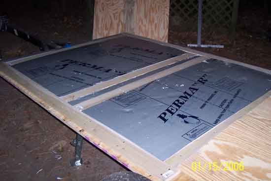

EZ, I don't know if you've seen any of my past posts about the surprise effect of insulation in my TD, but...
When I go to work on mine at the boatyard, and it's been like 90 degrees out and it's been baking in the sun all day...I open the door and it's COOL in there. REAL cool Yes, the insulation really DOES work both ways.
I did my floor insulation a little ass backward--I think. I think most people do it plain-side out, meaning the foil faces the cabin. I did it foil side DOWN, so it would reflect ground heat AWAY from the floor. (South Florida.)
What's weird about this is I think most people do it foil side out for the walls. Yet they do foil IN for the roof. Is there any logic to this at all? In my climate, I really didn't care--especially with 5000 btus of AC.
Also, since I only did 3/4" insulation on the floor and sides, I only used one layer of 3/4" in the roof as well, although my spar configuartion allowed for twice that.
I TRIED to get two layers of 3/4" in there for the roof, but without kerfing, try as I could, I couldn't get two layers to sit flush, so I just went with one.

Postby Ira » Tue Jan 31, 2006 9:04 pm
I don't have any dead space in my walls--stick framing is 3/4", and insulation is 3/4' thick.
Floor isn't an issue, and the insulation is wedged in there like a mother, and screwed in (plus washers).
As far as the roof goes, I guess I have dead space then. But never even thought that condensation would be a problem.

Postby toypusher » Tue Jan 31, 2006 9:08 pm
Joamon wrote:............ Also anybody know a good way to get insulation to stick to the underside of the floor should I decide to insulate it later?
Just put some asphalt emulsion on and stick the insulation into it, then use screws with fender washers on them to make sure it stays. The insulation should be a tight fit to begin with and would say in place by itself until you hit the road. Make sure the screws are not too long that they go through the floor! :o :shock:

Postby cracker39 » Mon Feb 13, 2006 8:59 am
I have to agree with Ira on which side the foil goes. Attics are insulated with a foil lining that is tacked to the trusses at the roof, to reflect the heat back out before it penetrates into the attic. For that reason, being in Florida, my foil will be on the outside for all insulation. I am not concerned with reflecting heat back inside in cold weather. The foam will hold in what little heat I will need to add to the interior, if any. I want the heat from the hot sun reflected back outside.
As for dead spaces and condensation, I'd think if the interior and exterior skins are sealed properly, you wouldn't get any moisture inside the roof cavity. Most of the moisture problems you have inside a house come from moisture being put into the air from steam from cooking, showering, laundry, etc. You won't have any moisture generated inside a TD (unless you sweat a lot!!!). If the weather is hot and humid and you are using an AC, it will dehumidify the air anyway (and I will be using one). So, I will probably end up with some dead space inside my roof too, and I'm not concerned about it. I may get some of the bubble insulation and piece it where I have space left and then, I may just leave the spaces.

Postby cracker39 » Mon Feb 13, 2006 10:24 pm
Ira, I looked at foam again today at HD. The 3/4" foil backed foam has a higher density than the plain foam (and R value of 5), but doesn't bend very easily. But, then, I had an idea. For the 1 1/2" curved sections on mine (the roof) I thought about two layers of the cheap bendable foam (R value of 3 per 3/4") with aluminum foil glued to the top of the outside piece. That should give the same results as the foil backed foam, and have more insulation R Value than the 3/4" walls. The cheap unlined foam will bend in a fairly tight curve, more than I'll have in my roof.

Postby critter » Mon Feb 13, 2006 10:56 pm
hey all,
in my build i used a layer of 3/4 and a layer of 1/2.fit great with 2/2 limber.i just glued them together.worked for me. :thumbsup:

Postby Sonetpro » Tue Feb 14, 2006 5:58 am
I am agree with Dale and Ira. More concerned with heat in Texas. I am using 3/4 stick construction. I have foil facing both inside and out. Facing out is 1/4" foil bubble wrap and facing in is 1/2" foil faced panel.
I'm using 3/4" tounge and groove,3/4" stick amd 1/4" sandwich construction, sealed with boat bottom paint.

Postby cracker39 » Tue Feb 14, 2006 8:26 am
I asked a clerk in HD about the foil bubble wrap and he had no clue as to what I was talking about. I looked really good in the insulation section, and I didn't see any either. I guess I'll check at Lowes. If I find it, I may use the same setup in my ceiling. Layer of bubble wrap and layer of foam, but I'll use the unfaced bendable foam on the inside. I don't see the need for foil on the inside face. Foil on the outside should reflect radiant heat, and the foam should stop, or at least slow down, heat absorption.
