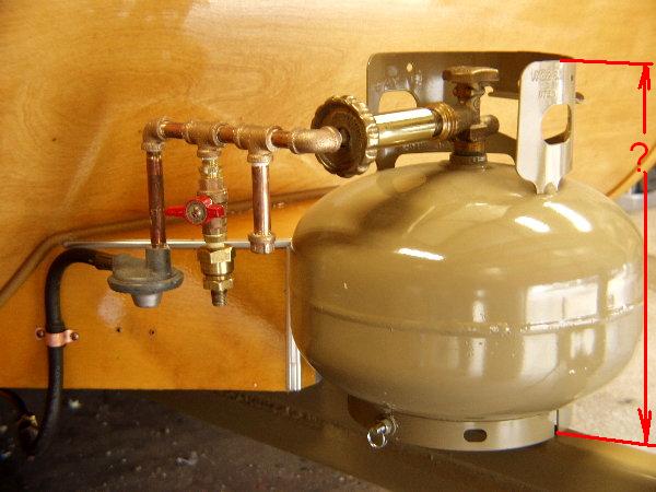

Propane...though it kinda smells the same :thinking:
Since like most folks, I dislike running out of gas at the worst moment, I've added fittings to a standard setup so that when the tank runs dry, a disposable bottle can be attached.

Postby mikeschn » Mon Jan 30, 2006 7:03 pm
Rob,
How tall is that tank and how many pounds?

Postby Steve Frederick » Mon Jan 30, 2006 8:18 pm
mikeschn wrote:Rob,
Rob, While you're at it, What's the tank mount look like??

Postby Steve_Cox » Mon Jan 30, 2006 8:24 pm
Rob,
That's a beautiful job you did there. What's the first leg down with the cap on it for? I wanna see a picture of the tank mount too!

Postby 48Rob » Tue Jan 31, 2006 8:15 am
Mike,
It is an 11# tank.
It stands 12.75" tall.
The mounting ring on the bottom is the same size as a 5# and a 20#.
It may be the same as larger tanks too, but I never checked...
Rob
48Rob
Posts: 3882
Location: Central Illinois
Postby 48Rob » Tue Jan 31, 2006 8:22 am
Steve and Steve,
Thanks.
The first nipple is a drip leg, to catch excess moisture, rust, or scale.
Here are a couple shots of the tank fitting,
If that isn't what you meant...the large tank mounts to the tongue by means of two bolts that have a hole drilled into the end for a security ring (kind of like a cotter pin).
The "mount" is a piece of steel stock bent roughly into a U shape and welded onto the tongue.
The upturned legs of the U are drilled for the bolts, which pass through the factory mounting holes on the tank.
Rob
