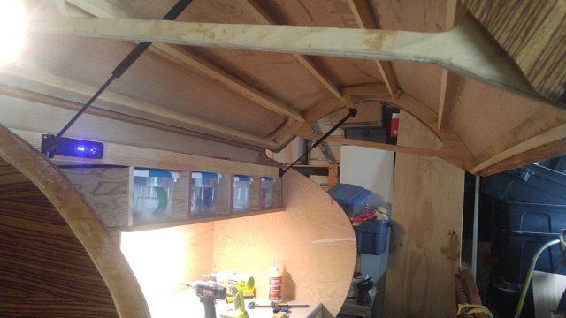

Postby Boreal » Fri Aug 04, 2017 10:59 am
Been searching around the site, and find myself to be in exactly the same situation as this fellow: http://www.tnttt.com/viewtopic.php?t=58439.
I have the struts. Problem is, as everyone who has ever ordered and installed these things for the first time, I'm pretty sure they're broken upon arrival. They are 100 pound rated, but when I put ALL of my weight on them, I cannot even compress them a bit.
Now, I know all about levers and stuff, but it seems to me that I should be able to compress them at least a little bit. Of course the true test will be after installation, when they presto chango work, all of a sudden. But what if they don't, and I have three holes to fill?
Some (any?!?!) reassurance would help me here.

Thanks for that, and the photos. And the thread.
I think I'm going to just bite the bullet and drill me some holes and see for myself. What's to lose? :D

Postby Boreal » Fri Aug 04, 2017 3:13 pm
Got it done. Unusual geometry owing to my hatch design. Video here: https://vid.me/qlY3E
