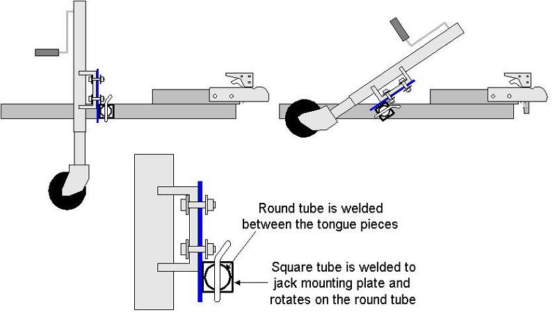

Did calling me a nut mean that I'm a nut for being so serious, or that you don't think it will work mounted rigid on the tongue? Well, there are other ways, and it's taken me this long to reply as I've been drawing another picture for you.
I can still install it inside so that it will swing up if I decide to. It means getting a piece of round tube that will fit into my 1/8" square tube. The jack mounting plate is welded to the sqare tube, then the round tube is run thru the square tube and welded between the tongue pieces. Two holes are drilled through the square tube for a pin. Then, two holes are drilled thru square tube thru the round tube for the pin, one vertical for standing, and one at an angle to tilt the jack up and back for traveling. I like this method better, but it is more work to construct. Here's how it's done:

OK, Ira, you got me to thinking again, and the design I posted on the swing up center jack stand is a go. I picked up a short piece of round tube today that just fits into a 2" square tube, just like in my drawing. It only costs me about $6 more than using the original outside attaching. The center stand makes for better balance when parked, and will look better too.
