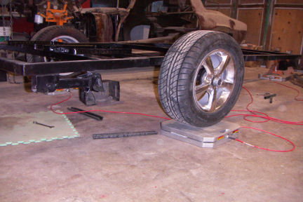

Postby Gaston » Fri Feb 03, 2006 12:27 am
I bought my axle from century wheel but it is the same as the dexters in fact I think they are made in the same plant in Texas. to get the tires offset to the body side I used 15"x 6, 32mm offset , front wheel drive wheels. It puts the nside of the rim 1/4"fron the outside edge of the swing arm. I ground a little off the arm to round it and get another 1/4" . It tucks the wheels in nicely.
try the wheels you want to use to check if the center hole will clear the hub. I had to machine 1/4 out to let the hub thru.Image
mine are Eagle 192's 5 on 4.5 the 14" x 6" would hit the swing arm
