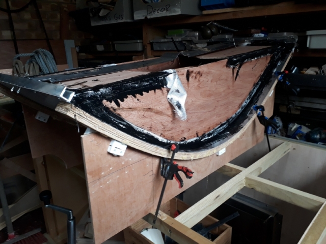

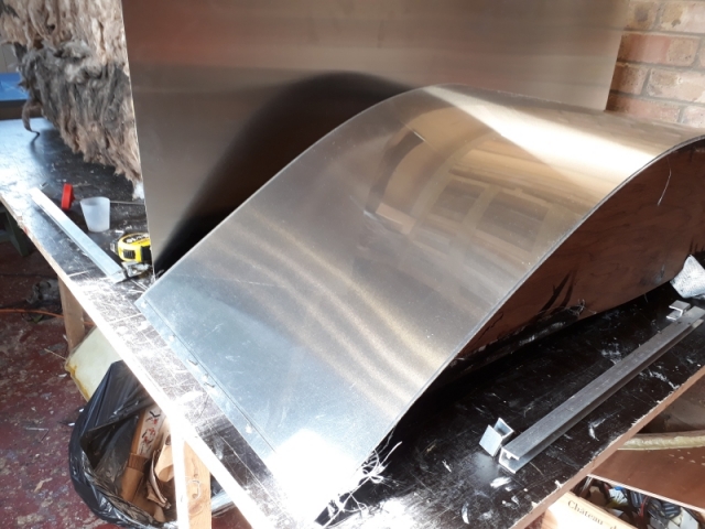

I took a pattern off the window. 6x3mm thick 40mm wide strips of plywood clamped and PVA glued.
From this I set in a sheet of 1mm Ally and built wooden supports to keep its shape. I used Glass tape a Oven Flue Sealer (max temp 300C)

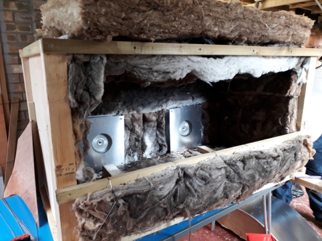

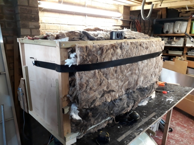

I built an oven walled with rock wool

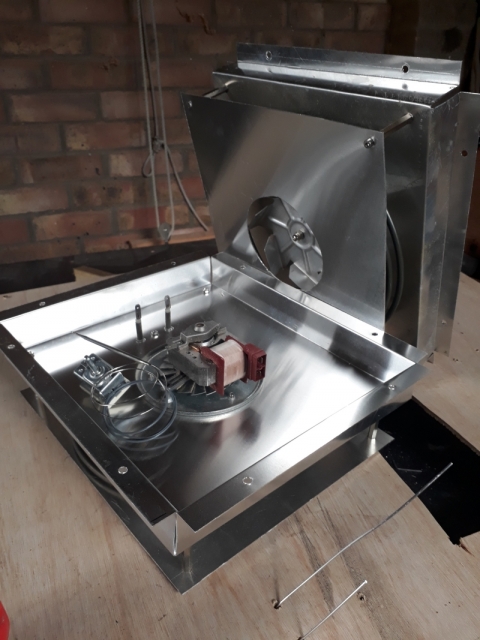

Heaters were parts for fan assisted ovens and temperature controller was of the bulb type.
Heaters were 2kW 230V rating and wired in series for 1.25kW
(Later I took one out which raised the power to 2.5kW but left both fans running.

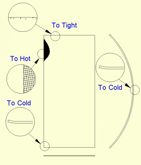

1. Test runs I encountered the following problems
To hot – bubbles formed in the material – Solution de-gas as suggested by the manufacture
Cold lip curl – The sheet would curl up at the ends which could have been cold and in the middle which could again be to cold.
2. Tests runs

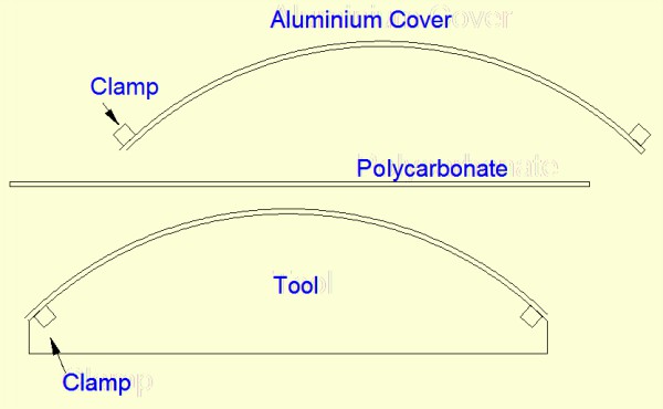

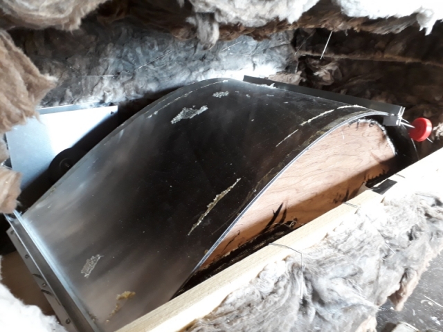

I Decided to use a top clamp to hold down the curl edges.
This gave rise to marks under the clamps, solved by loosening the clamps a little.
This image shows the clamp in place, the red object is a meat thermometer, cool down took longer that I thought.
Here the bent ploycarbonate is fully con-formal to the tool.

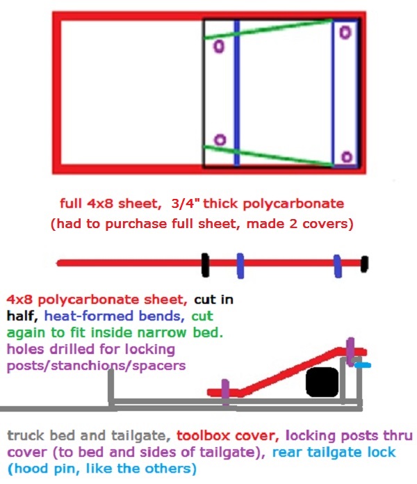

  • My polycarbonate supply at work was only 1/4" thick, seldom thicker, so I bought my 3/4" material at a supplier near home. It was expensive, even back in '92, when I built it I constructed a bending brake from 2x4's I had at my Dad's house (I lived in an apartment at the time, after a divorce, thus needing to secure my tools), and used a hand-held Bernzo-matic torch to bend it into the shape I wanted. I used the torch a bit too closely to the wooden brake and polycarbonate, charring the wood, and causing bubbles in the polycarbonate, but it looked pretty good. The material was formed into a sloped wing-shape, to cover the toolboxes, allow wind and water to flow under and over the wing (and waterproof Contico toolboxes), with holes drilled to use hood pins with polycarbonate spacers (from scrap pieces at work), to hold the cover to the bed floor, and on the bed sides. I cut additional angles so the cover would taper up from the narrow bed, to the wider bed sides, and rest on spacers there. I also drilled a hole on the left side of the tailgate so I could put a hood pin there.
  • I used matching padlocks on the four pins holding down the cover, and a separate trailer coupler lock on the tailgate. I painted the inside surface with the same metallic charcoal grey as my truck body, as contrast with my black bed box (inside bed mount, not one visible over the rails), and the black bedliner. I also applied a large red Chevrolet decal on the underside of the cover, before painting it, so it was strikingly well-done, especially for a first attempt. Later on, I used the other half cover temporarily while repainting the first, and quit using them after I started driving larger pickups daily, with the old S-!0 being driven for a while by my second wife. The cover(s) were used from '92-'03, and got thrown away after the truck was totalled in '04.
  • While it served me well, protecting my tools (with the added benefits of better traction and 1 mpg gas savings), it didn't have the seamless look a properly formed (with a forming oven) plastic should have, and despite that, it drew many favorable comments as a great idea, but mediocre execution. Polycarbonate is so pricey now, that I would use steel or aluminum as my medium, instead, but I used what I had been using weekly/daily to repair items at work. Perhaps, now that I've built a TTT entirely from plywood, I might use it to do the same thing...now to find a good S-10 ....
