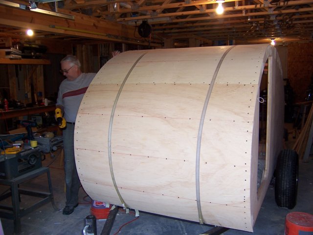

For my roof outer skin I used water resistant luan from H.D. 3/16" @ about $10.75 a sheet, it made the bends nicely.

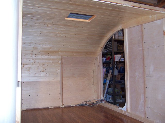

And for the ceiling I used Tung and grove pine from home depot, 3 1/2 " planks about 3/8" thick, which I wasvery happy with.
