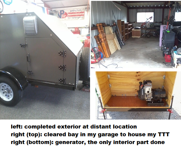

  • I built my exterior structure of 3/4" plywood, with no insulation, nor anything inside (except for my on-board generator in the galley. No interior, no wiring, no windows...just a completed shell. I did finish the exterior, with multiple coats of polyurethane and acrylic enamel paint over it, and with doors and hatch mounted with all the requisite hardware. I did it that way, so I could bring it home from the 50 miles distant shop where I began the build, to my own garage (the completed coatings on the exterior were for protection when I transported it home, and for possible outside placement, if I didn't have a garage bay cleared for its' arrival).

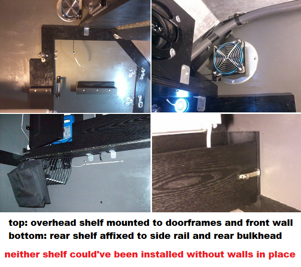

  • Even though my construction methods, fit and finish were rudimentary, as compared to most TDs and TTTs, it was what I thought was needed at the time. But, as simple/crude as my exposed wiring and hardware were, it was still a real challenge to design and build the interior, having to make hundreds of entries/exits thru my doors to complete the interior (especially, when making modifications as to fit and finish of already-mounted parts, inside). And, just painting the inside was tough, using brushes/rollers overhead to paint the ceiling, surrounded by heater (it was very cold at the time) and paint tray beside me. I used high-VOC paint, so the fumes were really bad, though I used a cheap vapor mask, that didn't filter much. Finishing my galley/storage area, and installing my A/C and ducting wren't as difficult, standing outside the galley, but anything inside the cabin was painful, as my knees and back were starting to go.
  • If I were to build a complete replica of my squareback TTT today, I'd probably paint the interior before the roof went on (painting both sides prior to mounting the roof/ceiling), but after that, I'd still have to build outside-in, due to the way I mounted everything inside the cabin, relying on the rear bulkhead and front wall/doorframes to hold interior parts (the intersection of sidewalls to front and rear walls was the main structural support for many heavy items). My now-bad knees and back wouldn't like it, so it would take me twice as long as it did before, 5-6 years ago. Using unusual materials and re-designing as I went, veering way-off my planned design, made that the only way I could build it, then or now.
