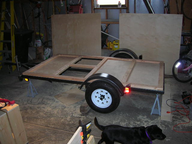

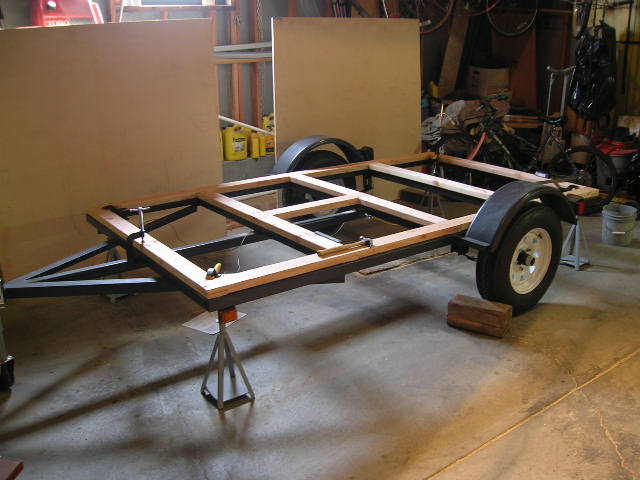

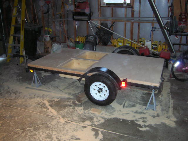

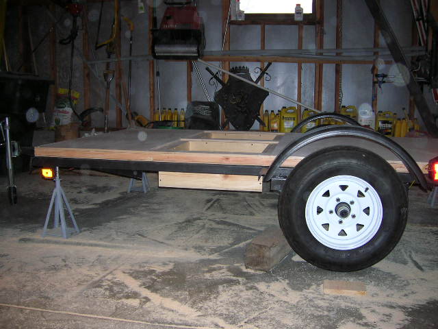

THe weather was warmer this past weekend so I got the itch to start building on my trailer. I bought some Baltic birch plywood and some 2x4's and worked all day Saturday. I used 2x4's for the frame, lapped the joints and glued and screwed them. I used 1/8" ply for the bottom and 1/2" ply for the top floor layer. I wanted to have some storage space so I copied an idea I saw here on this forum and built two boxes and recessed them into the floor frame. I used 1x8"s which didn't hang down too low. Still gives me the clearance underneath. And it won't look too bad either. I still need to paint the bottom with roof tar/sealer and fill the the floor with insulation. I will build the removable panels at a later date and I don't know whether to hinge them or leave them lift-out. But I was excited to at least get SOMETHING done on it, the trailer. Thanks for all the good ideas on this forum. An here are the pic for all to enjoy!

Very Nice!
Do you have some scrap ply??
If so, I would replace the 1 by 8's with ply..Just in case you whack the lumber with a rock, it might split?? Not so with ply!!
Maybe I'm just nuts!! :?
Nice job on the frame also!!
Blessings, Steve

Postby sunny16 » Mon Feb 06, 2006 12:37 pm
I thought about that but I don't have a table saw to get the straight cut at this time. In the future that may change, so I used the next best thing I could find. And if my van, which will pull the trailer hits anything first, I'm in big trouble anyway. There is plenty of clearance. The boxes are higher than the axel. But good thing to think about. Thanks.

Nice job on the dropped floor. Well, everything actually. I'm looking at that rib running down the middle... I know you had to go around a steel member..
I ran into the same situation with Lil Diner #1. Steve has since improved that situation with Lil Diners 2, 3, & 4... possibly more... Steve, do you have a photo of your frame with the dropped floor in it?

Postby sunny16 » Mon Feb 06, 2006 5:34 pm
And mikeschn,
I thought it was you who posted a dropped floor/storage before here. I liked the idea. And I thought about one big removable panel but two would be easier to get to if you are in the trailer. You can sit on one side or the other and open them up. So, whatever works for you. And yes, there is a metal frame member that cut thru right there, the tongue.
