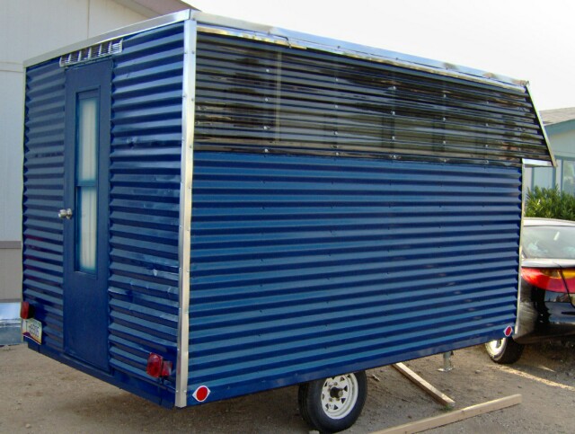

Postby Projector » Wed Sep 05, 2018 9:25 pm
Well, without knowing what I was doing, I built this framed with metal studs.
Since I didn't know what I was doing, I doubled up the studs placing one inside the other and used self tapping screws to bind them together making them solid. Skinned it with corrugated steel panels.
A real HF+ HD special. :D
Came out pretty strong, weight? Don't know.
Went cross country with it twice and it held together so I considered it a success.
