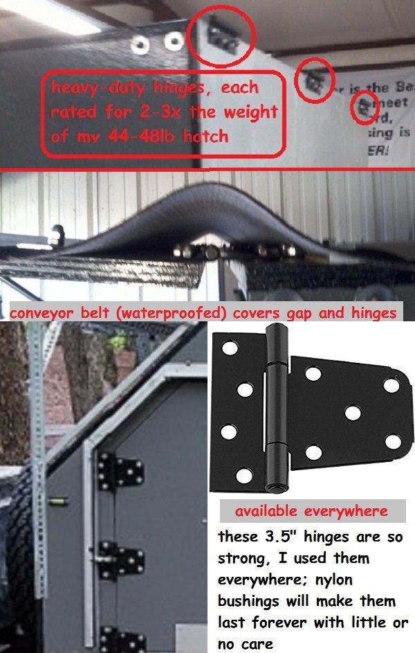

  • I use Jeep-style gate hinges, powder-coated? black, available at any big-box store, were my choice, They were very strong, durable, with nylon bushings for quiet use and low wear. I used three on each door (and on my vertically-hung hatch door), for extra resistance against ever sagging ((if you ever had an old Camaro, you'll know what that's like). The hinges were installed with the smooth carriage bolt head of some bolts, facing the exterior, so no one could easily unbolt it, and decorative acorn nuts on the other bolts. The latches chosen were also gate pieces, modified to make them latch very tightly, attached in a similar fashion. The two latches (on each door) can be padlocked shut, or open (so nobody could lock you in), while a drop-bar door latch system I fabricated, secures the door when inside.
    hatch hinge.jpg (168.99 KiB) Viewed 1804 times

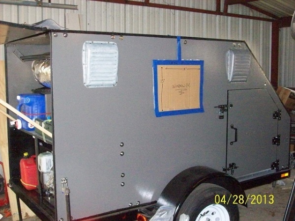

  • Re: the window placement, and attachment...the windows are high up, to make them harder to enter (or break & grab thru) from outside, small enough (15"x 18"), to make entry more difficult, and are installed using a pair of security-head bolts, in addition to the normal screws. I experimented with window placement, using a template inside and outside, until I determined the best position (where it's hard to see or reach inside, and while inside, I only needed to sit up to see out).
    trying to find ideal window placement using template.jpg (100.62 KiB) Viewed 1804 times
