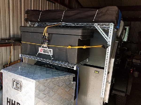

Postby working on it » Fri May 18, 2018 9:07 pm
If you're building one, or buying one, be sure to get one large enough to hold all you want to, the first time, rather than having to get a larger box, later. I couldn't find what I had in mind, before starting to camp with my trailer, and ended up having to scrap a good toolbox I used there, as an interim solution. Some people possess the skills to construct one from scratch, in metal or wood, but I knew I couldn't, so I got mine off of E-bay, for a little over $100. Then I spent a week of my time, and just under $75 in materials to make a sliding base for it. I tried to keep it a traditional look, with hidden features, though now I've gone and spoiled the look by adding a double-rack sitting over it. Shoulda just stacked my storage boxes there, like Slow and Sparksalot suggest.

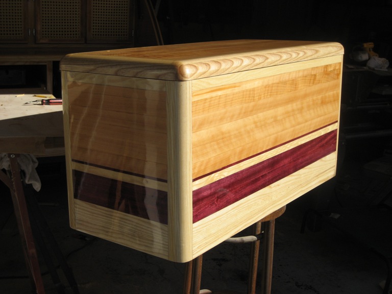

Postby aggie79 » Thu May 31, 2018 7:58 am
If you're building a tongue box, keep in mind how the lid will open and plan for clearance.
I built my tongue box with the lid hinge on the side of the tongue box (short dimension) so the lid opens to the side and the tongue box can butt up against the front of the teardrop.
For a conventional tongue box with the lid hinged at the back (long dimension), leave enough room between the tongue box and teardrop so there is room for the lid to hinge back past vertical or add some type of lid stay so the lid can stay open by itself.
Re: Tounge box tips please
Postby edgeau » Sun Jun 03, 2018 5:29 am
aggie79 wrote:If you're building a tongue box, keep in mind how the lid will open and plan for clearance.
Good point. Nice work too. Looks like an old timr sea fearer's chest.
