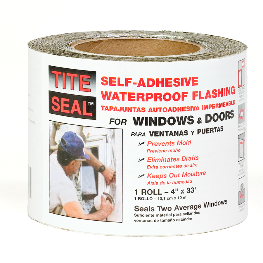

Postby greygoos » Fri Jun 15, 2018 12:43 pm
I have used window flashing tape before putting on the skins.

Postby cfiiman » Fri Jun 15, 2018 4:45 pm
Thanks everyone for the replies. I thought about that flashing tape, but it looked a little thick to me. I really like the aluminum tape because it sticks really well and is very thin. Thanks for the ideas.
