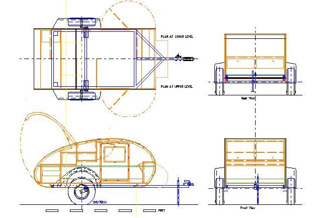

I'm working on wacking Andrew's Modernistic CAD design, and am wondering if I could do an appropriate tongue box for it. I want something that echos the eliptical curves.
Something rectangular, would IMHO ruin the lines.
Does anyone have any ideas, pix, etc?

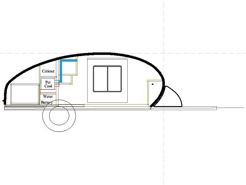

This is what I was thinking [the tongue box barely shows up, sorry about that, I'm slowly learning QCAD, between core dumps]:
Andrew, is this what you were thinking?
I am personally unsure how this would come out. I can't visualize it in 3d.
rob

Postby Sonetpro » Mon Feb 13, 2006 5:42 am
That's the profile I am going to attempt. I'm building a 5 wide, Going to make the box 4 wide.

Postby angib » Mon Feb 13, 2006 8:07 am
Rob,
I would say that was close to 'spot on' - the only thing I would do is try to get the top skin to go nearer horizontal where it meets the body. But that would depend on whether you can bend it that much.
Making the bottom of the box lie on top of the tongue, rather than going down to level with the bottom of the tongue, might make it a lot easier to build.
