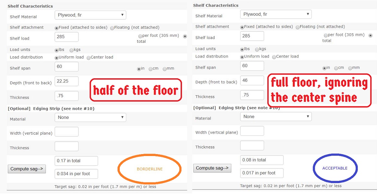

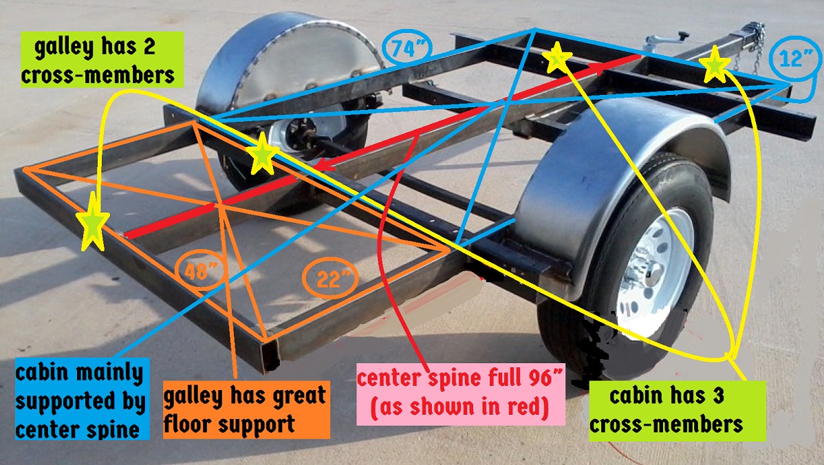

  • As illustrated above, my decision to add 1/4" on top of my base 1/2" birch plywood floor, was because the large 60" x 46" spot (total area inside the perimeter frame, minus the two cross-members at front & rear), inside the cabin area, that was only supported by the center spine of the frame. The cabin area had two inches resting over the rear cross-member, and the front was well-supported with 2 supports for 12 inches of flooring. On each side of the frame, only 1" of plywood contacted the steel, so I used the 38 Tek screws primarily to assure full perimeter contact there, though both front & rear floor-ends have 1.5" of frame underneath.
  • That large area in the cabin, with roughly 1335 square inches on each side of the center spine being unsupported, would be under my mattress, so if I slept or kneeled on one side, it would've had to support up to 285 lbs (myself, clothing & gear, 1/2 mattress, etc.). So, I treated the floor as a shelf, so I could use the "Sagulator" https://www.woodbin.com/calcs/sagulator/ to calculate the permissible loading.
    my floor, treated as a shelf, on the sagulator.jpg (182.47 KiB) Viewed 3170 times
  • This calculator convinced me to use the additional 1/4" sheet, just to be safe. We have a large shed where our contractor used too thin a floor, and it sags, so I didn't want the same condition to befall my otherwise-toughened trailer. More is better. I'm sure that the center spine, and the other half of the flooring, spreads the loads, but I wanted to be sure.

Postby lacofdfireman » Sun Aug 19, 2018 12:17 am
So here is a photo of my frame I built. Do you think I’m better off just just bolting the 1/2” ply straight to the frame or building a wood frame out of some 1x2or 3’s and glueing a 1/4” sheet on top of the frame first then bolting it down? Is there enough cross support on my frame to do it this way?
