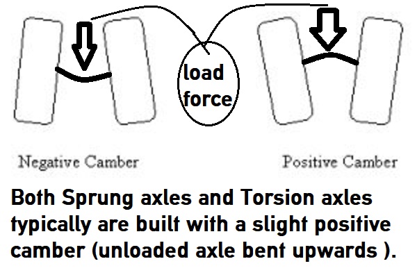

***** The only thing I see wrong in your pictures is that you've placed your axle in a "negative camber" position . Both Sprung axles and Torsion axles typically are built with a slight positive camber , so that heavy loads will tend to straighten-out the pre-bent axle, so that the wheels become straight up-and-down.

And good catch by working on it. The axle is on upside down. Don't know if you were just mocking it up or what.

Yes I am aware the axle is upside down. Was shipped to me this way so we had just set it on there like that. It has since been fixed.
I needed up cutting off the hangers and mounted them correctly. What a mess. Was a PITA to cut those off but was able to get the, Off with a cutoff wheel and the. Was able to get the rest with a sanding wheel on my angle grinder. We are good to go now. I think I Orders my axle about 3”to long though. I have a 3” gap between the trailer side rail and the tire sidewall bulge. I would have rather only had about a 1.5” gap. But I’ll live with it. Will just need to make wider fenders. Also that puts my width from outside tire to outside of tire at 87” which is a little wider than I’d hoped for. But I really wanted to build this for a queen bed so I’ll have to live with it.
