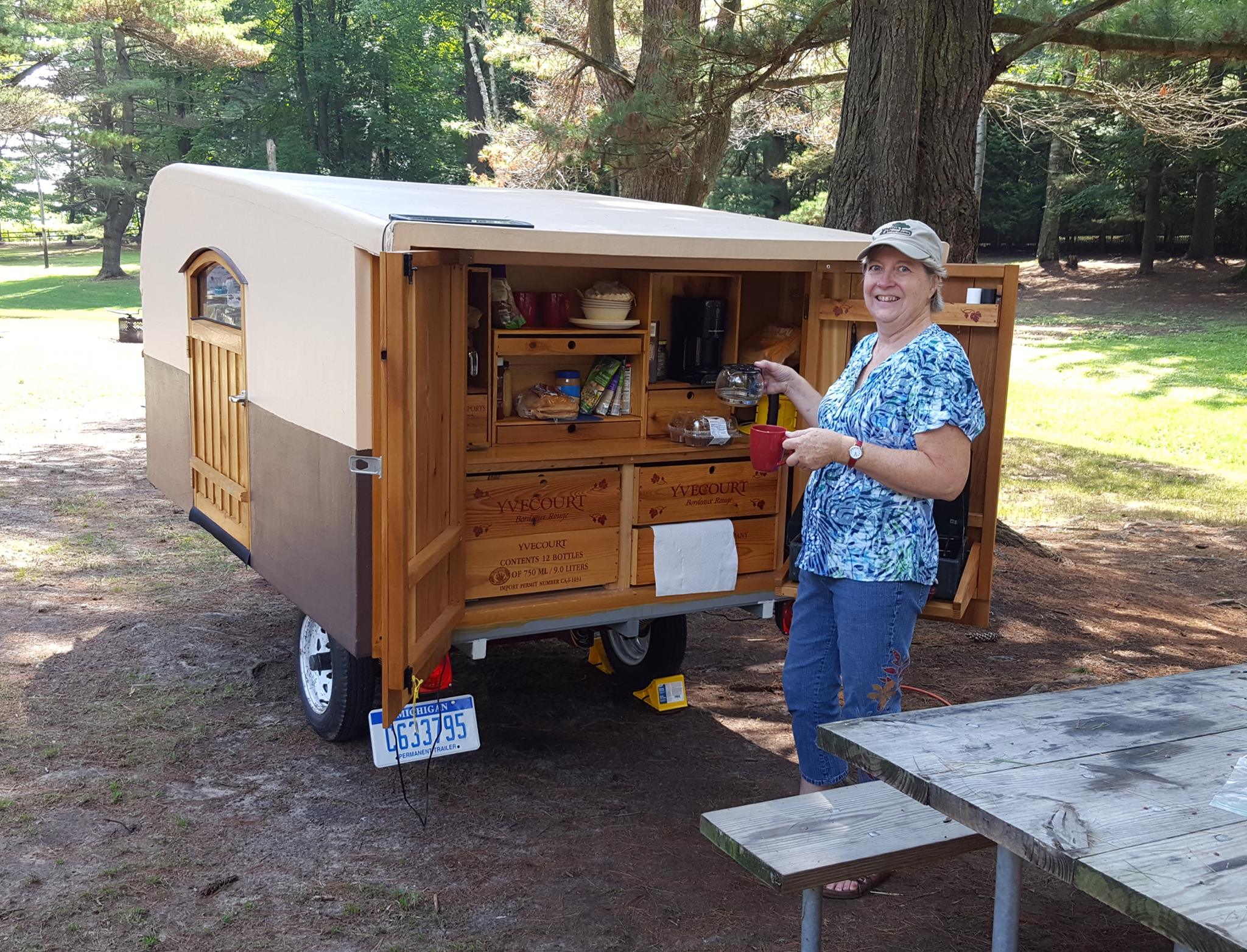

Postby Bob Hammond » Sun Aug 26, 2018 4:34 pm
The Nutmeg is 60" inside width, and 66" outside - very near the width (& height) of my Subaru Forester. The length inside the cabin is ~88", and the depth of the galley is ~12"
