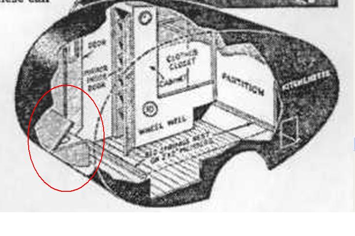

Postby mikeschn » Sun Feb 12, 2006 6:16 pm
The midget did it this way...
However, as Andrew pointed out, did it really fit?
Here's another concept I came up with... It's a bit larger, but if you need a Loo, you may want to consider this...
