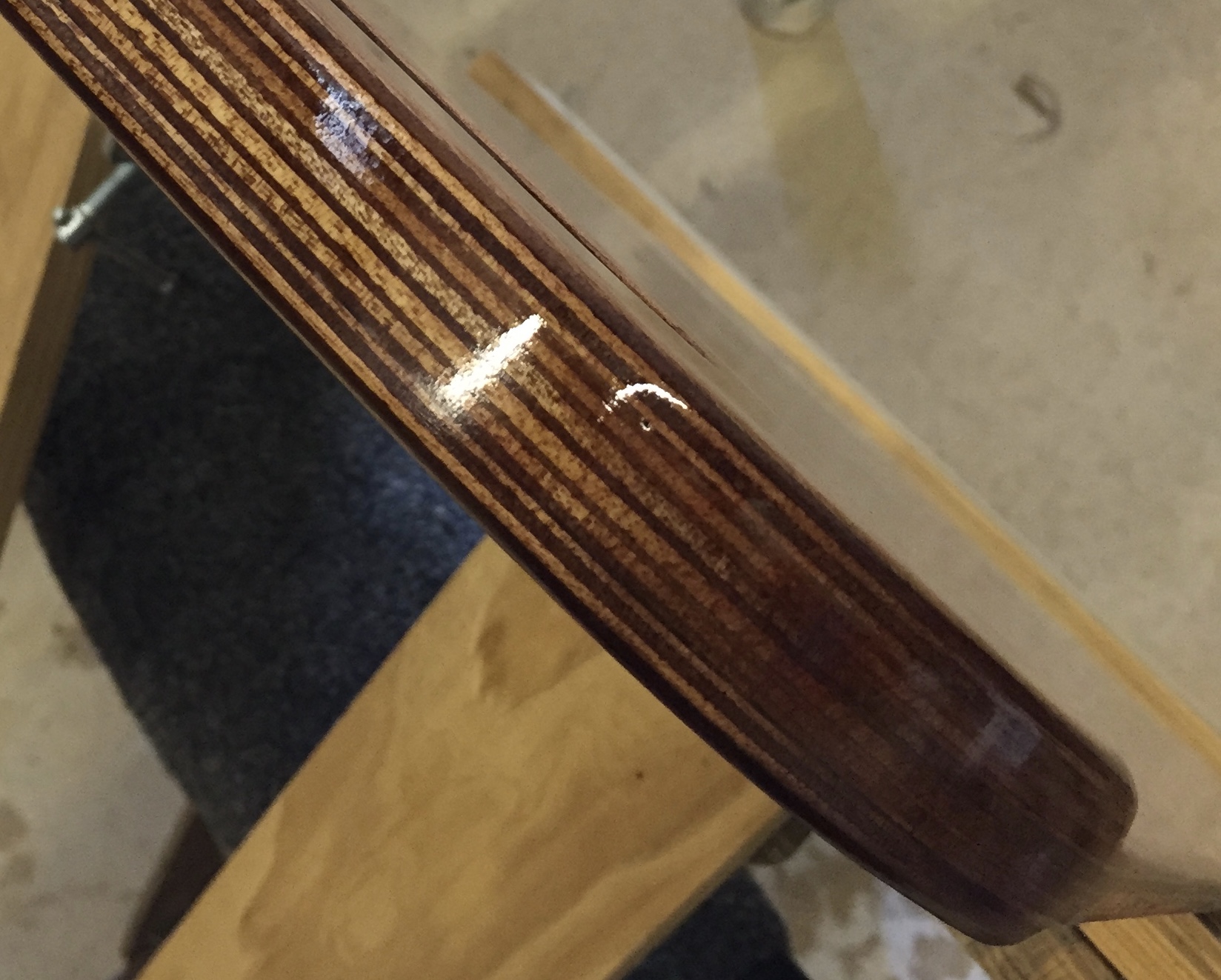

Mike, your concept is fully doable using MARINE PLYWOOD, EPOXY & GLASS CLOTH
the wood grain shows beautifully thru the epoxied glass giving it a varnished look when you coat the epoxy w/ several coats of good marine varnish
epoxy and the sun are not friends as a general rule and the epoxy does require a UV barrier (several coats of a good marine varnish works well)
the edge grain of good marine plywood finishes quite well when epoxy coated first
here is a pic of 3 layers of marine okume plywood laminated together epoxy coated and varnished
edge grain epoxied & varnished
the 1 little hiccup in the pic was repaired and you would have had to have it pointed out to find it
i doubt that if i had not brought it to your attention the fact that this is 3 pieces wouldn't have occurred to you
if you use care with your build the edgegrain on good BS1088 marine plywood(species of your choice) will IMHO enhance your work

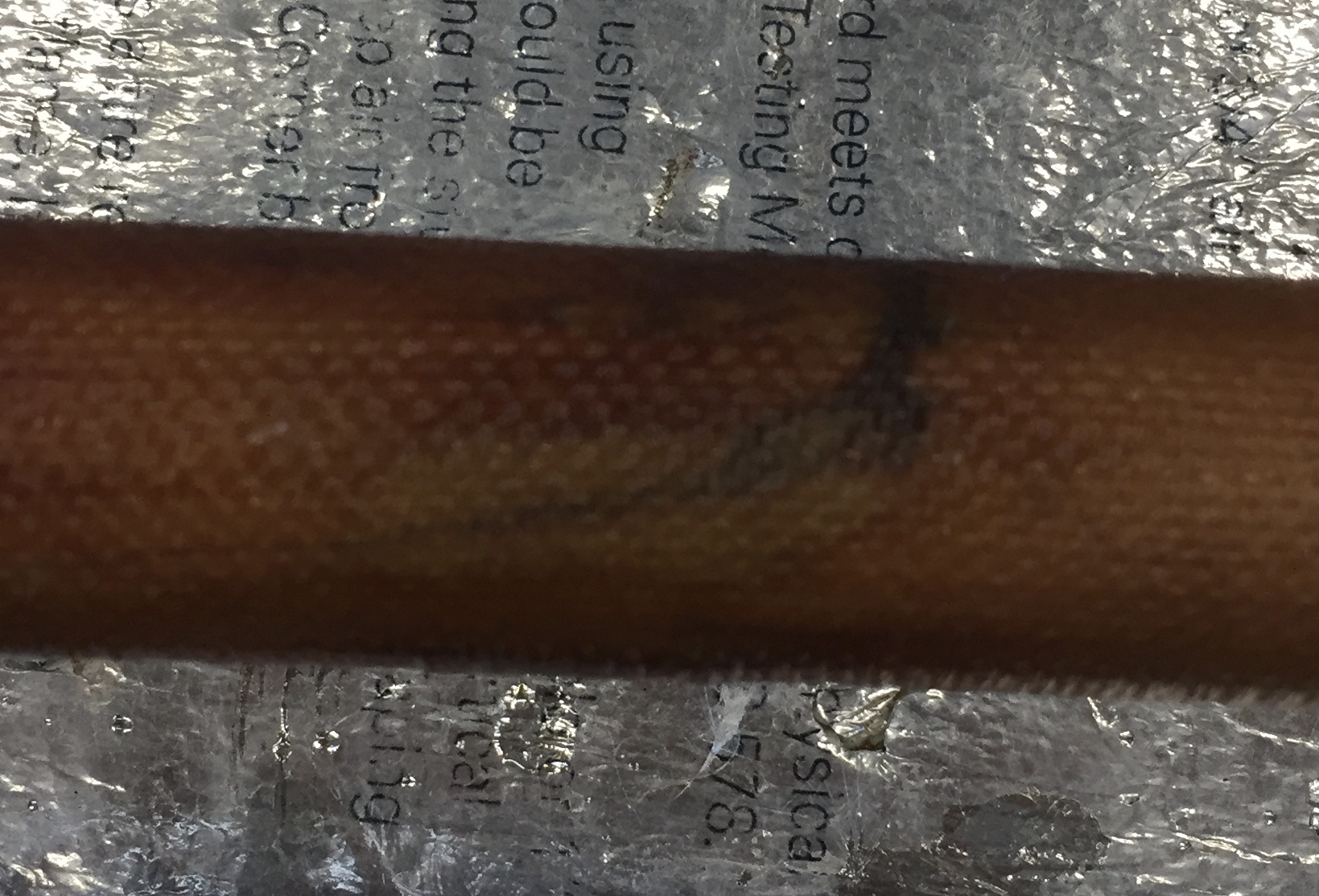

here is a pic of an old home made oar the grandkids broke and i have glassed over the repair w/ the 1st coat of epoxy
at this point simply dragging the spreader over the weave will feel like it is dryish
allow this coat to cure slightly (just barely tacky) and apply a second coat again beginning in the middle
this is called HOT COATING and the result is one thicker application instead of several coats that are layered
repete this step until you have a totally slick surface
if you allow these last coats to cure completely it will be necessary to sand between coats
when the pox is almost finger nail scratch cured you can cut any excess cloth away w/ a sharp pair of cheap scissors being careful not to lift the glass cloth away from the wood
once fully cured a rasp will knock the excess cloth off easily
one caution before i sign off is to be sure to use 2 PART EPOXY not FIBERGLASS RESIN which is a polyester product and is hardened w/ drops of catalyst(usually an MEK family member)
ALWAYS WORK IN A WELL VENTILATED AREA AND WEAR BREATHING PROTECTION AND NITRILE GLOVES(many of these chemicals will melt latex and you don't want this stuff on your skin!)
