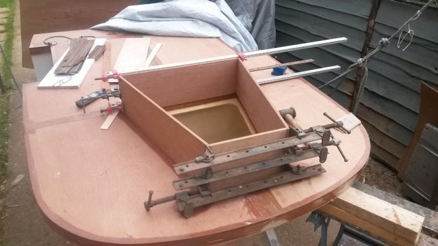

Postby Woodbutcher » Sat Nov 03, 2018 7:30 am
This is what I did. The picture shows the floor upside down. Just remember the drop can't be deeper then the suspension allows, or you will hit stuff.

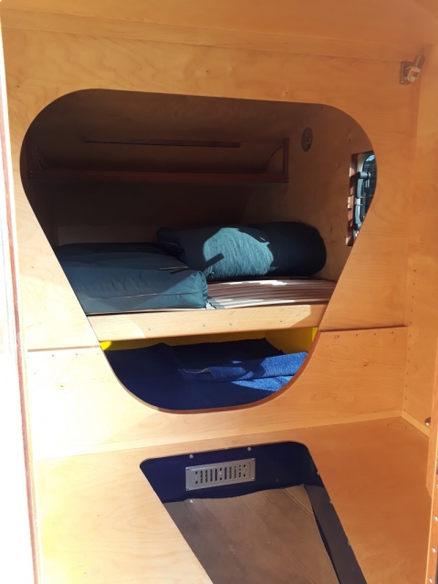

Postby Woodbutcher » Sat Nov 03, 2018 9:28 am
I stand in it.
here is an inside picture.

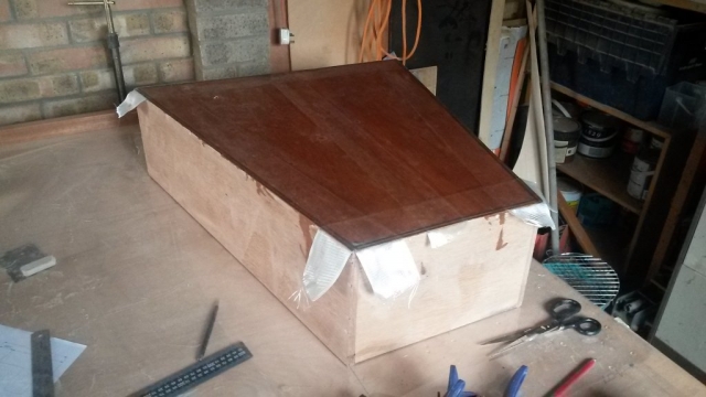

Postby UK-Corlett » Wed Nov 14, 2018 11:34 am
Hi
Something to think about are road hump. I live in fear of bashing into one.
I have a drop floor in my TD, but I made it strong enough to stand in but it has thin ply walls which are edge-on weekly jointed.
If it comes into hard contact with an immovable object it should disinterested without ripping the floor off.
To this end its just screwed at the sides.
