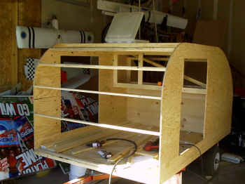

If you look upper left corner of the photo you can see my coroplast RC airplane that I fly. The stuff is virtually indestructable.

Postby Spadinator » Mon Feb 13, 2006 3:55 pm
Hey Trail....yes and no.... I am going to skin the roof and ceiling with coro and paint the sides. I will use 2 mil inside and 4 mil out side. We have a local supplier of the stuff so i can get it a whole sale prices.
Hey Ira you can't roll the stuf with out damaging it's appearance. It will go around curves though. I'll see it I can't take a photo of how I am going to do mine to give an example.

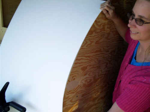

Postby Spadinator » Mon Feb 13, 2006 4:06 pm
I'm still learning so a spad would be a good crash plane
I lost orientation on one and flew it through a tree top. The only damage was a broken prop!! :shock:
Here is a photo of how the Coro will look on the trailer. The "flutes" will run horizontally allowing it to bend around the corners. The sheets of Coro I buy have the flutes running in the 96" direction.
