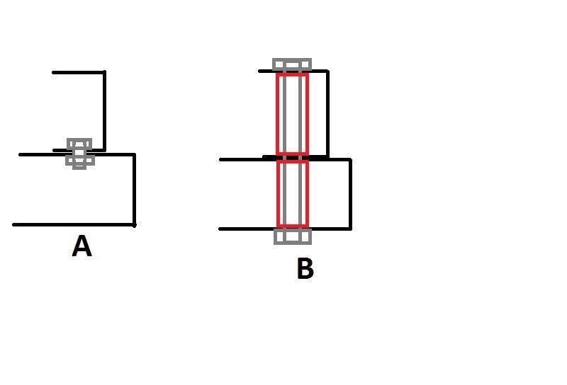

One of the little niggles with the bolt together trailers is the way the two draw bar members are bolted to the rest of the frame.
As far as I can see, the top plate of the C channel of the draw bar is bolted to the bottom plate of the side chassis member and of one cross member.
See illustration A. It's not a lot of metal taking all the stress.
Has anyone done illustration B? i.e. use a long bolt that will reach right through all four plates, put in a couple of spacers so the steel doesn't crush (the red bits in B ) and at least bolt 4 plates together instead of two?
I hope my attempt in MS paint demonstrates what I mean.

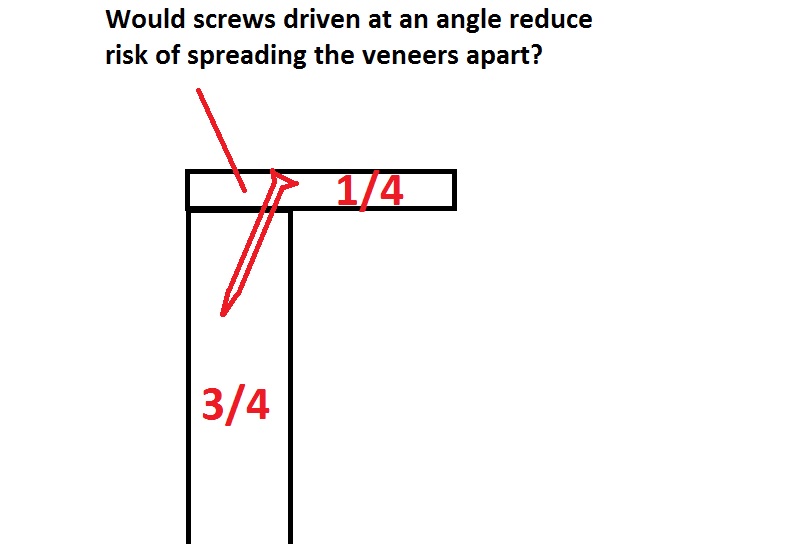

I know about them. They don't appeal to me as a way to join a 3/4 ply sheet to a 1/4 roof sheet without having to add perimeter frame to the wall.
I certainly would consider them if I decide to go the full frame route.
Then again, maybe a kreg jig would make it make it possible to drive screws at an angle so the screw crosses plies instead of spreading them apart.

Postby KTM_Guy » Sat Feb 09, 2019 9:05 am
I think using spacers is a good idea. extra work cutting them all but worth it.
Use 1/4" crown staples from an air gun to attach the 1/4" roof to your 3/4" walls. They go in so fast it doesn't split the plys. Rally it is just holding it till the glue dries.

I guess if the staples are fired across the line of the wall, then each leg of the staple goes into a different ply in the wall, so only have the stress of one leg trying to push the veneers apart. And smaller diameter than a screw anyway. Do you leave them in?
