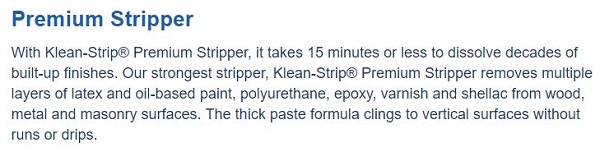

lacofdfireman wrote:...So basically what I’m asking is do I strip the trailer once more and start over again or can I just do PMF over this or even “The Mix” over this? Thanks....
At this point, I wouldn't try using anything short of this:
klean strip.JPG (57.87 KiB) Viewed 1493 times
premium stripper product description.JPG (49.21 KiB) Viewed 1493 times
It'll remove the poly already applied, and should make the wood ready for the correct oil-based "mix" . At least, it has worked for me on other oil-based paints, and should easily remove any water-based stuff. I prefer using the aircraft paint remover on car projects, so I tried this one on wood, instead. It was many years ago, and I don't remember what it did exactly, but Klean-Strip products are what I use.

Postby lacofdfireman » Thu Mar 14, 2019 11:36 am
Well I figure at this point I’m only into this reskin about $120(4 sheets Douglas Fir AC plywood) so I may just pull it off and reskin with 1/4” Baltic Birch that I found at Home Depot for $27 per sheet. Its cheaper than the Douglas Fir.
I I go the stripper route and it doesn’t work then I’m out that $40 at least. So might as well of just started over again. And I’m not sure how to use the stripper. Do you just roll it on? Then what does it do?
I have a few days to decide my game plan as I’m in the middle of moving also so time is short right now. Maybe after a few days what I’ve already done will be dry and I can do a test spot and see what happens. If the titebond 2 will adhere to this stuff I’ve already done I may just leave it where it’s at and do the PMF over this. Seems from talking and reading that when you do PMF “The Mix” really isn’t necessary.
