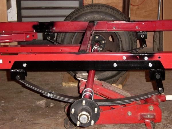

Postby kristaology » Tue May 07, 2019 7:06 am
This is not exactly like my trailer, but the black painted leaf spring mount is the problem here. I'm at work (oops) otherwise I would get you a picture of my trailer! I just need a flat surface to mount the luan flush and trim the bottom.
Could I remove it and mount it back through the luan? I feel like that would instantly crack the luan.

Postby Tomterrific » Tue May 07, 2019 10:14 am
I don't think it is a good idea to mount the axle carrier over the exterior wood. It would weaken the mounting too much. You could cut the exterior fascia to go around the carrier. Just paint the carrier heavy so it looks good.
Another idea I just had is to do the above and use another piece of the same exterior fascia over the carrier. The luan plywood fascia would be close to the thickness of the carrier metal so a new piece cut to cover the carrier should fit and look okay.
Or, space the entire wall out enough so the Luan fascia clears the axle carrier.

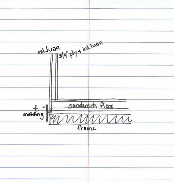

So I had an idea, and I'm wondering if anyone had any advice on the subject. T-molding. The stem slipped between the floor and the frame and the T runs over the exterior wall and the frame, allowing water to run off, IF :worship: I can seal the trim correctly. Butyl tape is a go-to, which I would put on both the top and bottom of the trim if you get what I'm saying.
The bottom of my floor has fibered roofing tar on it, so this may help seal as well.
What do you guys think?
Here's a quick office sketch if you need a reference.

Postby tony.latham » Tue May 21, 2019 2:38 pm
I think you are asking for water to sit in that joint.
